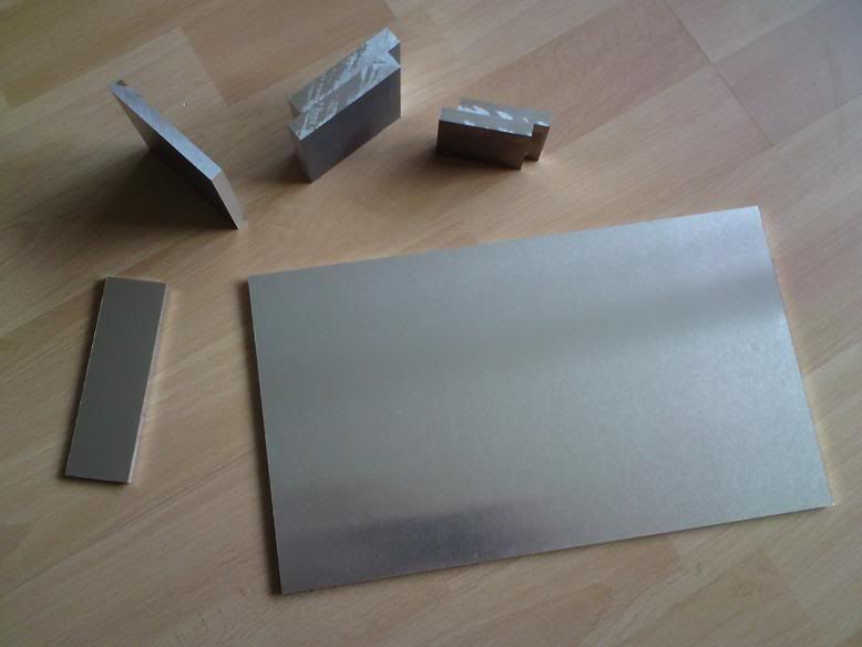

the material for the centerdiffmotormount is still waiting for milling
(mount: 7075 T651 ; plate: 2017A T6)

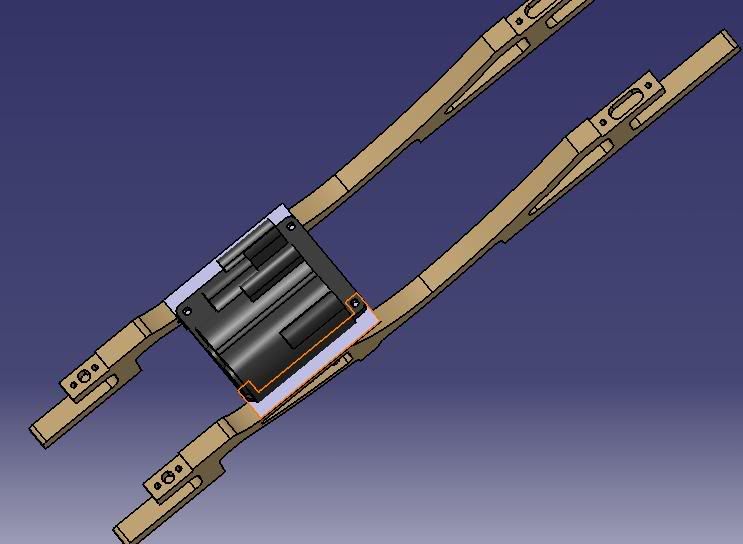

here's another version
i make a 3D e-revo transmission dummy to have a impression how it will fit between my Chassisbrace
and with two little parts it will fit
  (#34)
04.27.2009, 08:20 PM
Yep, FLM/ RC-M actually had a similar product for sale briefly that alowed you to mount the 3905 style tranny on the 3906 style chassis- discontinued now as FLM sell a dedicated 3905 chassis, but a few people have made their own basic version too.

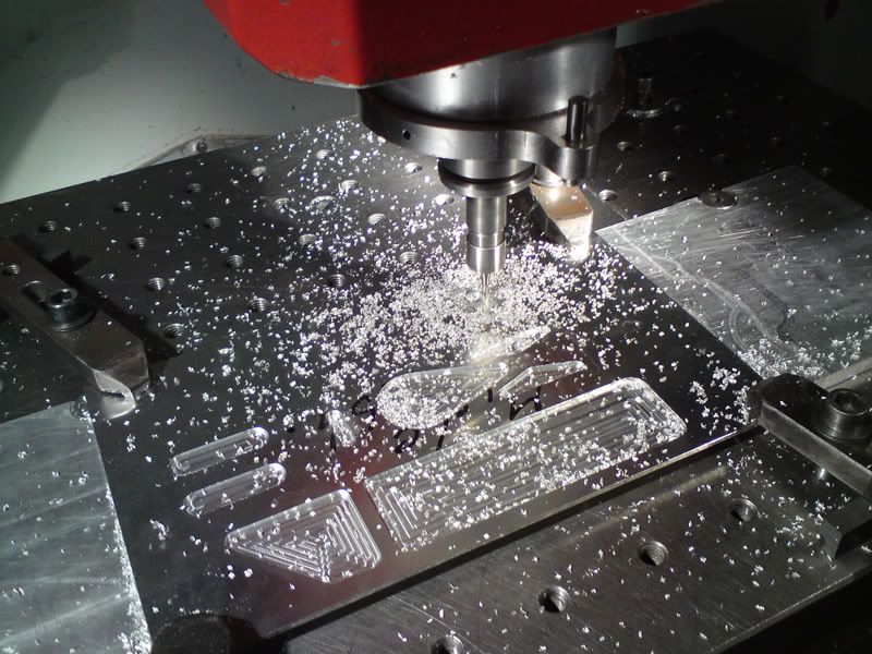

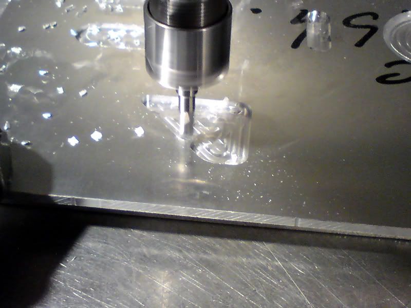

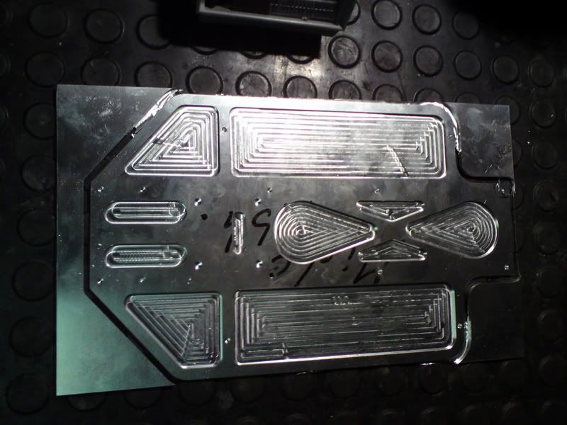

so i make a new chassisplate last night
1st version was a 24cell sidebyside plate
2nd version was a 14cell sidebyside/ lipo plate (cuted out of a 2nd 24cell plate)
3rd version is a lipoplate
and a short vid
next parts i makt tonight, hopefully

That is a sweet chassis
What grade of alloy are you using ?

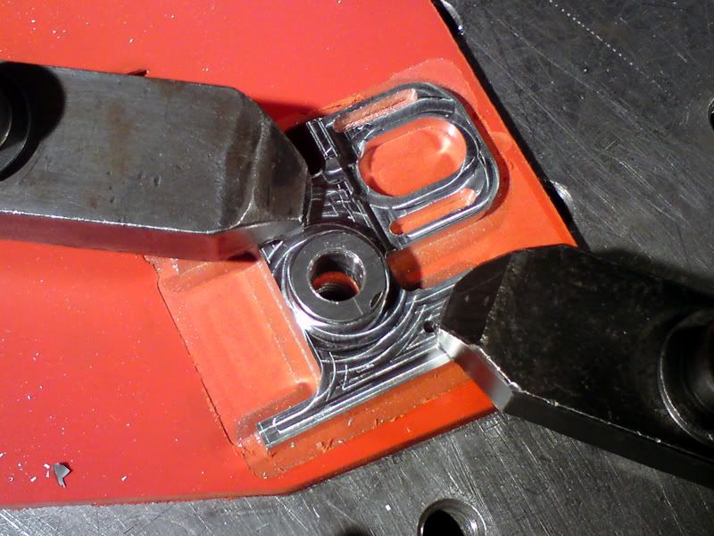

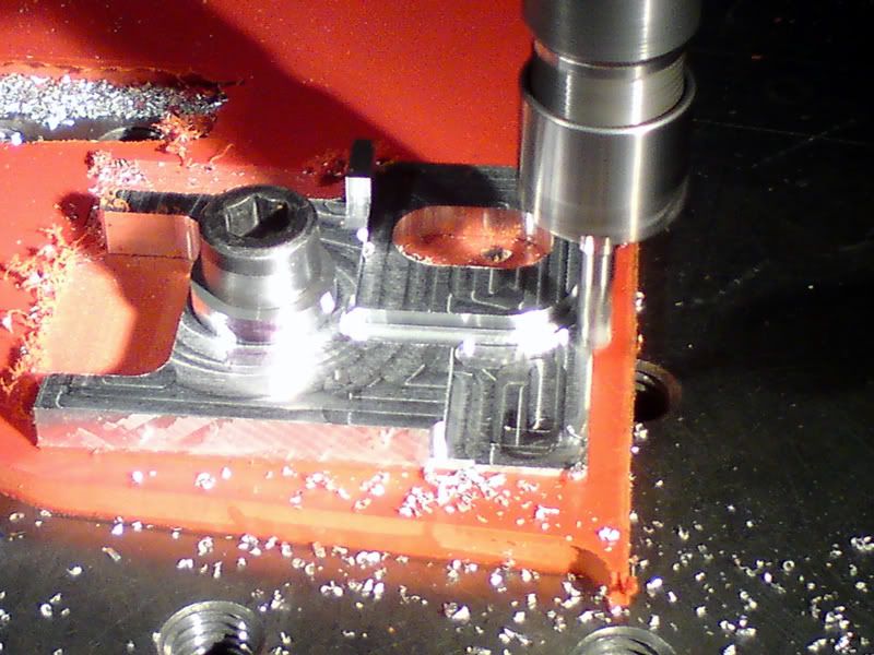

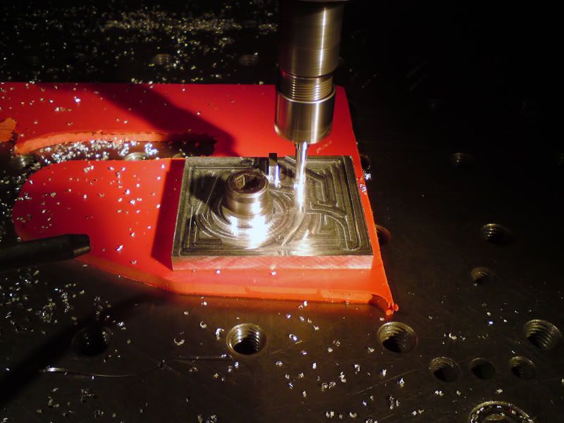

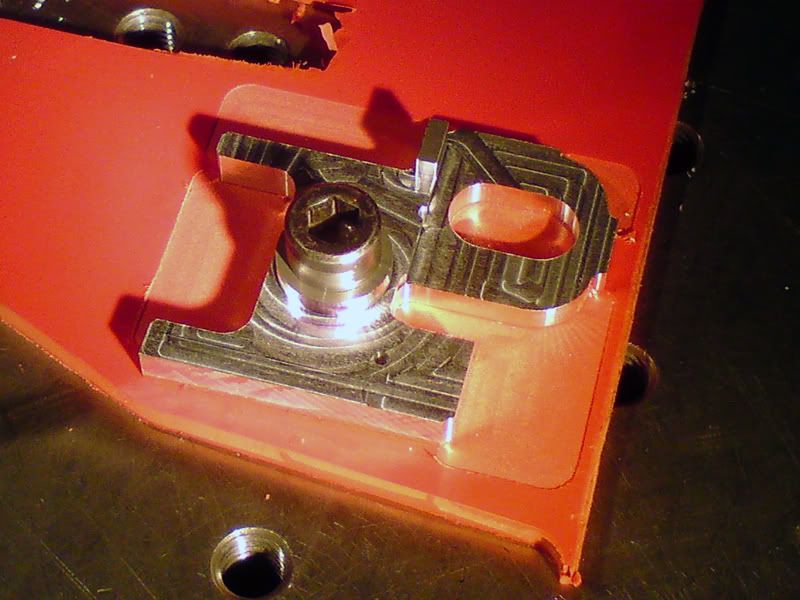

the new centerdiffmotormount
  (#41)
Delta Maxx
the new centerdiffmotormount - 05.03.2009, 05:32 AM
here it is
just have to make the threads
roughing all down
and a short vid from planishing(?) or finishing(?) the bearing area
(sorry for the bad quality it's from my C902)
hopefully get the front centerdiffmount today and the topplate
