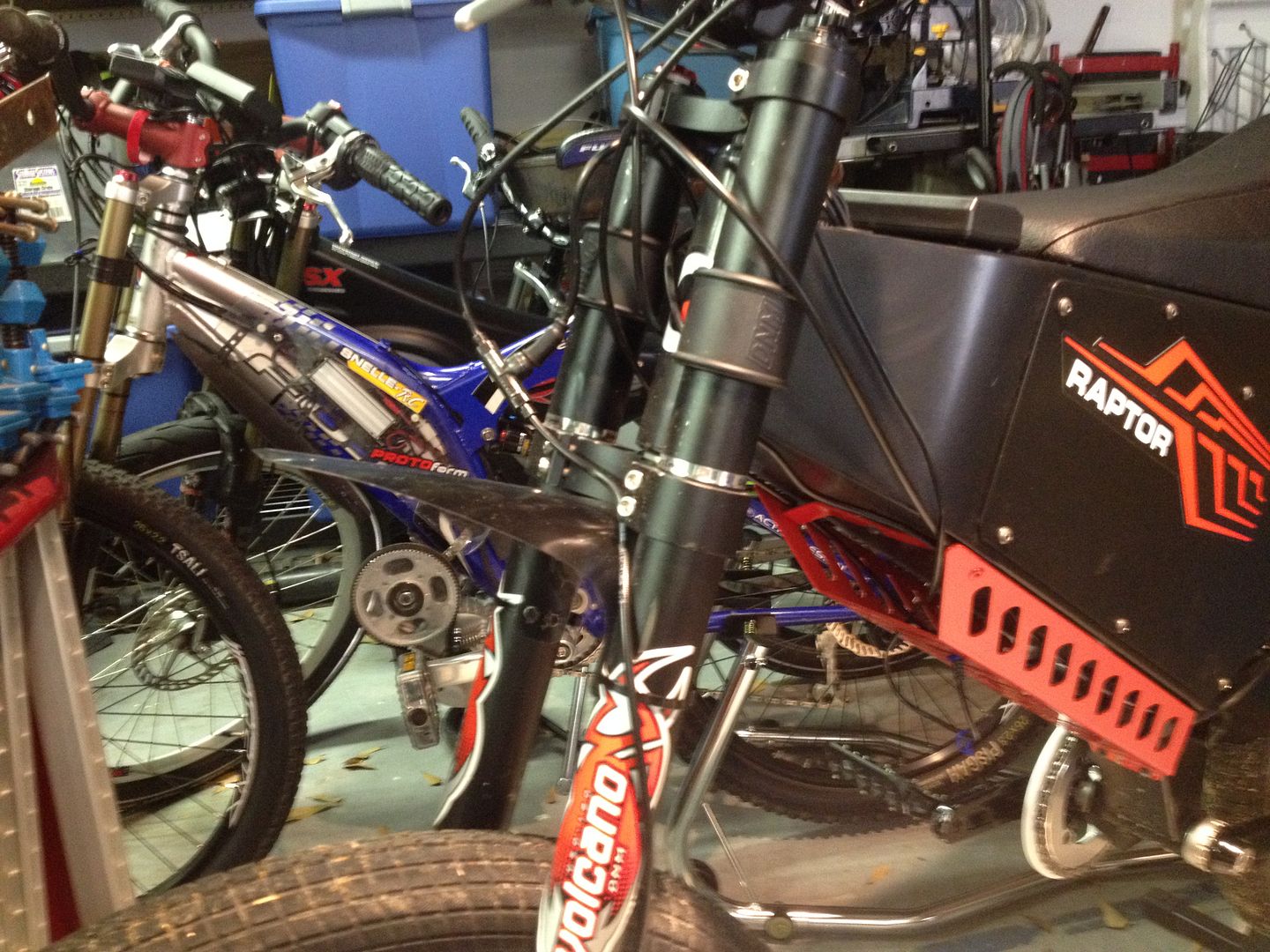

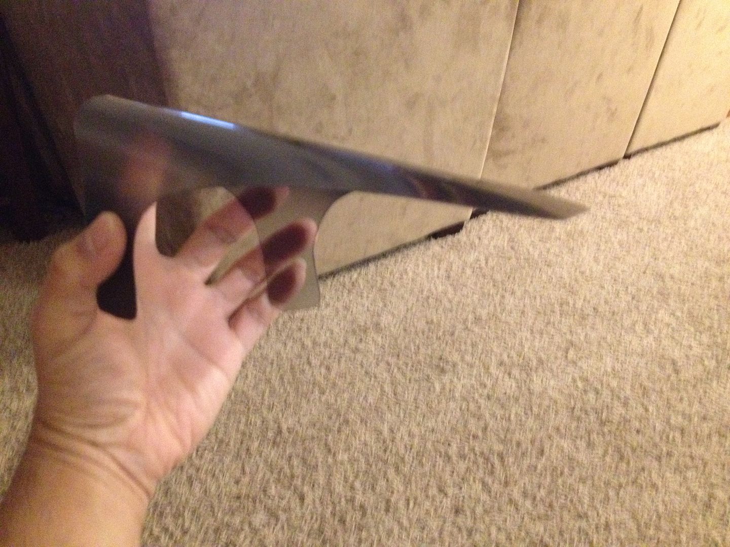

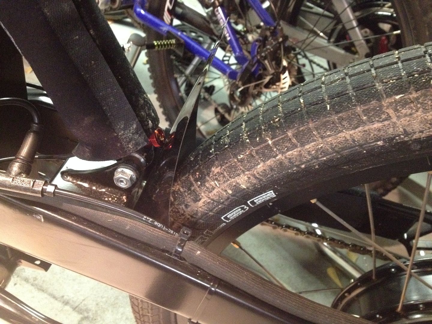

Made me a fender based of Mucky nutz. I used some privacy screen for an LCD monitor I had laying around. Still need to punch some holes in it to mount it.
6 KiloWatt A123 Racer
24s2p EVG SX 49.6mph Ebike.

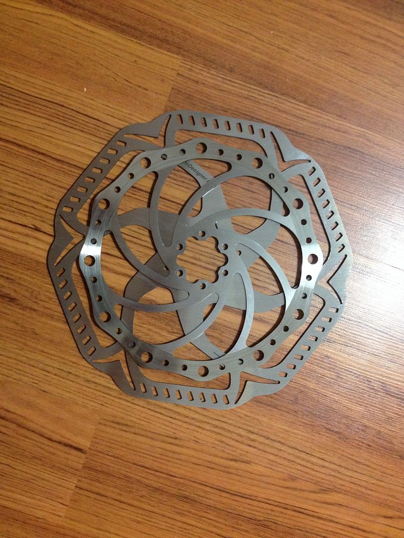

I got me some 255mm rotors. These are big!!
This is the 203mm on top of the 255mm.
From the top: 160mm, 180mm, 203mm and 255mm on the bottom
