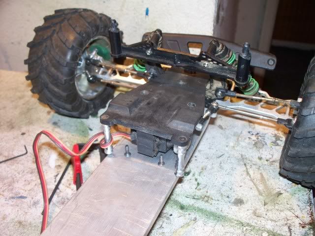

So I am sitting & looking at the Excess 1/4" 6061, I have here and I thinking I can make an easy extended Rustler Chassis. I already have the FLM "Extended chasssis" But it only pushes the wheelbase to 12.5" ( 1 inch extension) and that thing is still just a wheely king.
I have just enough to make a simple chassis that will stretch the WB of the Rustler to about 16 inches even. I am thinking about trying out a "Mini Baja" type vehicle. Instead of a body maybe make a roll cage out of some Nylon rods or something.

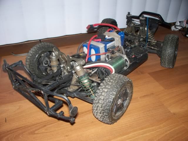

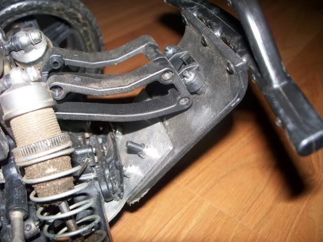

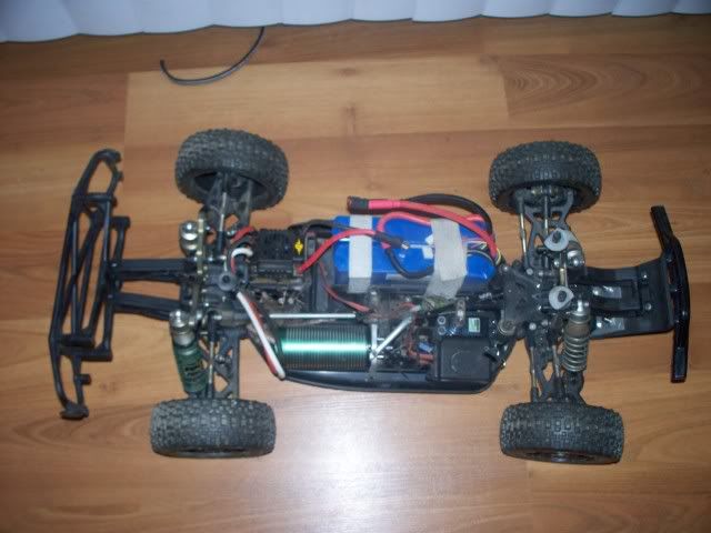

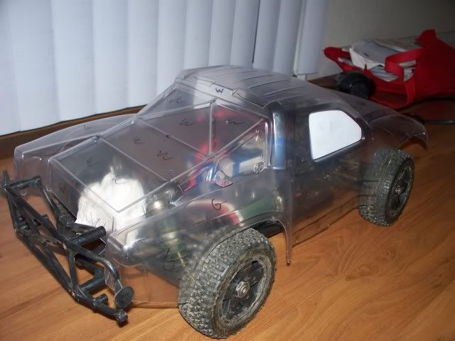

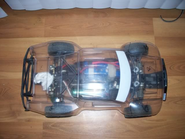

Some goodies from Christmas and I am getting a power upgrade and a new Short course look.
I got a Mamba Monster, 2 x 3s 5000 40c Zippy for 6s and I swapped my Castle 1520 in there.
SC10 Body, FLM Rustler bumper, RPM Slash front Bumper with SC8 Front bumper mount, SC8 Rear bumper and SC8 rear mount.
Photobucket
Photobucket
Photobucket

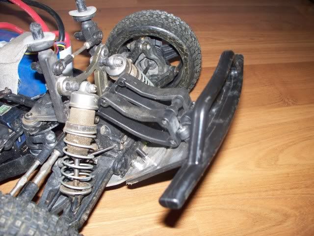

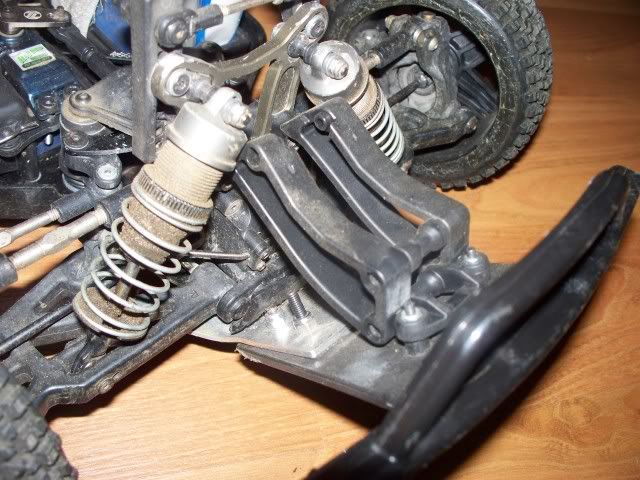

Here you can see Where I flipped the FLM Rustler bumper around. Mounted the RPM Slash bumper to it. Then drilled holes through so I could mount it to the chassis. Then I hooked Up the SC8 front mounts to the shock tower, and drilled two holes through the RPM Slash bumper. This thing is Rock Solid.

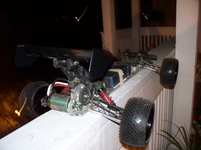

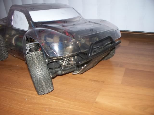

So here is the SC8 bumper Mounted to the Hinge pin cap. and Drilled two holes in the tower added a spacer screw and done.
Photobucket
Photobucket
Photobucket
Photobucket
As you can see here and the Top shot above. The length on the Slash bumper and SC8 bumper works just right...
Photobucket
Photobucket
Photobucket

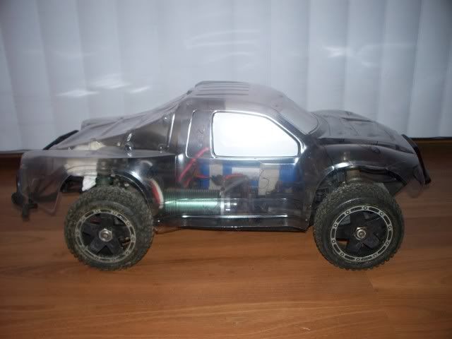

Towel holding the body up. I gotta redo the mounts... Should be simple, I use new square style Maxx body mounts, They are easy to mount and tough.
Photobucket

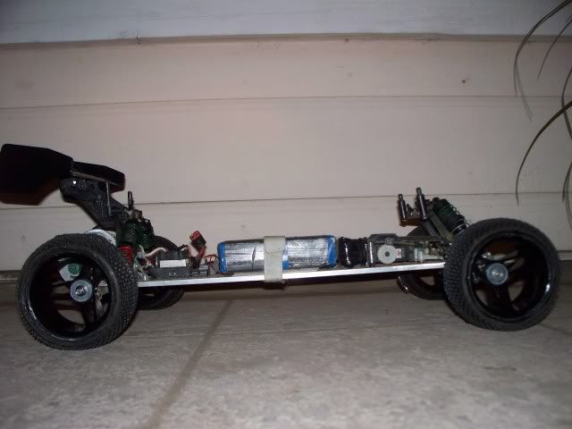

Well, I got the new bodies all painted and they are looking pretty killer... I got some shots but I am at work and I didnt load them to photobucket yet... I will post them up later along with some shots of the "Rustler"...

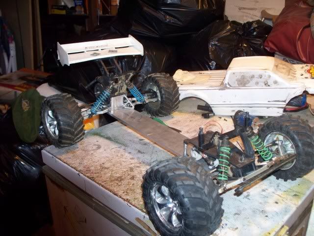

Well I made my new chassis for the Rustler. It was actually extremely easy. Only took about an hour and half to file, drill and countersink all the holes. Its not something crazy fancy, its actually more like a Low CG - Super Stretched Stampede. Only thing I need to MOD is how the Steering top plate connects. The plates sits about 1/4" too wide for my chassis. So I may just make a small Block to attach the chassis to the top plate behind the servo. Should be simple and actually will act as a battery stop for the front.
It is 1/4" 6061-T6511 ~3 wide (not at home, cant remember). Wheelbase is right around 16 inches, and is not too stupid looking considering the width ( I have the EXT FLM Arms). It should actually look pretty cool once I hook up some "Roll Bars" to get that Baja Look. This will be ran on the CC-1512 - 2650, Mamba Max and use either 3s or 4s Depending on where I will run it. Geared 18/56 I should be right around 50mph on 3s with my Masher 2k's and I also have some Badlands 30's (about same height at 5" ) I will most likely switch to when I get the Roll bar done. Now I should be able to mount the batteries far forward and blast on the throttle and not just wheelie all day. I would guess about 5-6 lbs when I am finished.

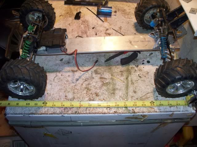

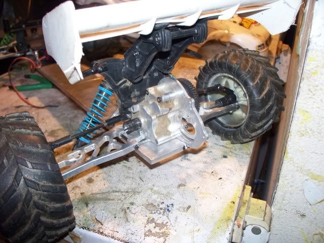

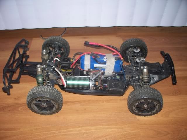

So here is where it starts. I have had the rustler for about 4 years and its time for a little change. It has all the hop ups I needed then and I will make it as bullet proof from here out as I can. I plan to make this a jumper, as it is very light and I will have some nice shocks on it. As you can see it is narrow but its pretty much the same width as my brother law's FLM stampede chassis.
Photobucket
Here you can see I have 32p gears. I think its a 56t Jato spur. FLM Tranny, And if you look up in the front, you can see the posts for the front top deck are just off too far by about 1/4"
Photobucket
Here is an easy fix I came up with. I will just drill two new holes in the top deck, and mount the posts 1/2" closer to the center and 1/4" back (I put the screw app. where I'll mount it). This will also be an nice battery stop when I as some sticky foam to it. I got a 20kg/cm servo. So it will be no problems steering this. I also will put on my 4mm turnbuckles I had for over a year sitting here and replace the 3mm crap...

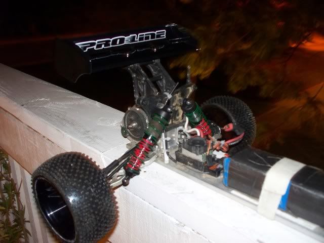

Another shot of the Rear. I keep the bearing carriers plastic as a weak point. I plan on tapping the arms at the hinge pins and using set screws. I have some serious slop around the holes and I dont want to send them back to FLM yet. But I probably will later and get a new full set...I also have Ofna dog bones for shafts so no worry on twisting them...
Photobucket

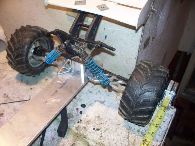

Shot of the rear tower with an Ofna Raze wing mount.
Photobucket
The mounts that came with the FLM chassis really made this easy and solid.

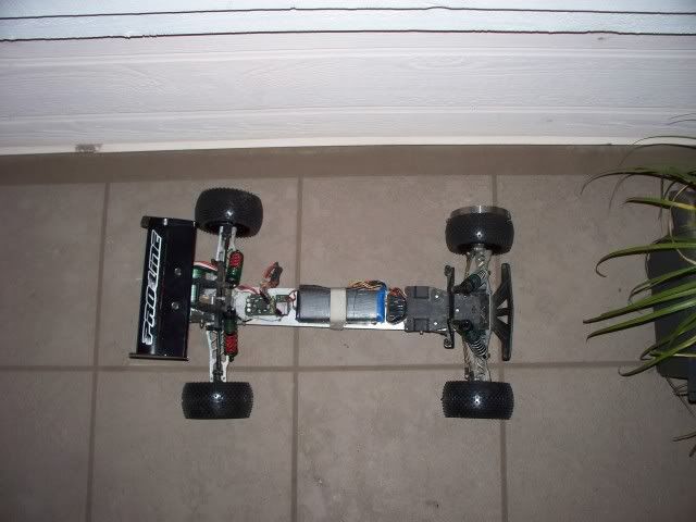

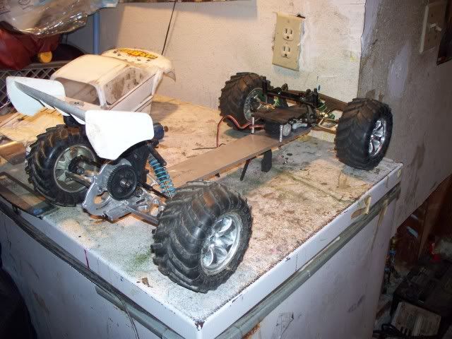

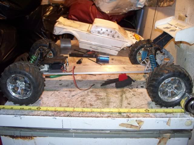

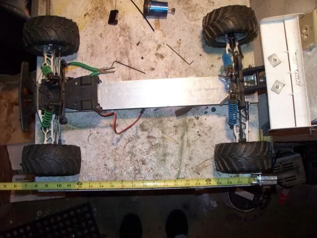

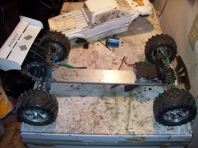

And here is a shot of the wheelbase. It ended up at about 16.4 inches.
Photobucket
Photobucket
Photobucket

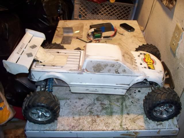

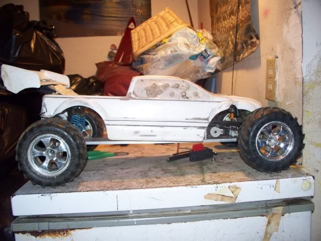

So I threw my old E-maxx body on for fun. I will probably bash it in half till I can come up with a roll cage, but a little shoe goo here and there I should get a dozen runs or so... Its got tape on the windows and rear from when it was muddy and I didnt want it in the car...
