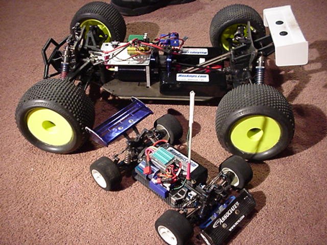

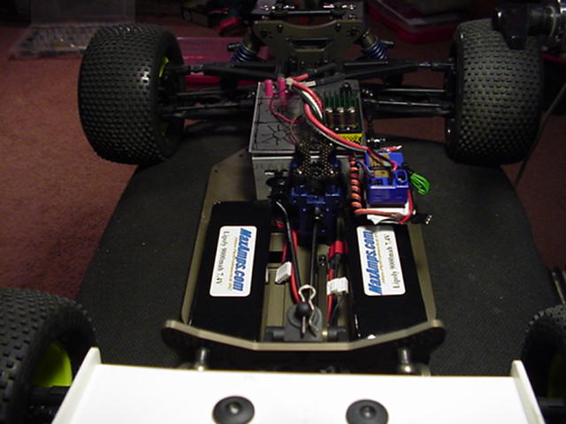

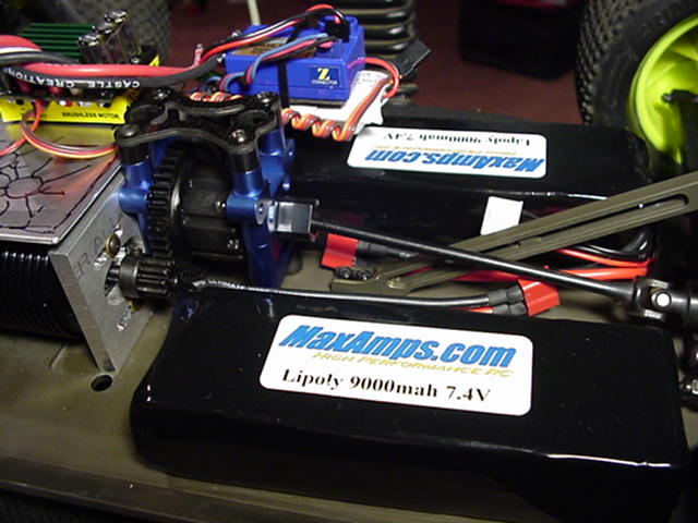

Well here is what I have came up with so far with my CRT conversion I made my own mount and mounted it to the diff and bottom of the chassis along with the top plate the motor mount should be strong enough to take some abuse. I like the one peice design from Scyan simple and strong. :)
Here's the parts I'm starting with-
Neu 1515 1y motor
Mamba max ESC
2-2s3p 9000mah Maxamps lipo packs
6v UBEC
Ice charger
Kyosho 46t plastic spur gear
I found some aluminum center diff mounts on Ebay for 28 bucks for the Jammin buggy and CRT
I cant wait to see the look on the nitro guys faces when they get smoked by a electric CRT:005:
