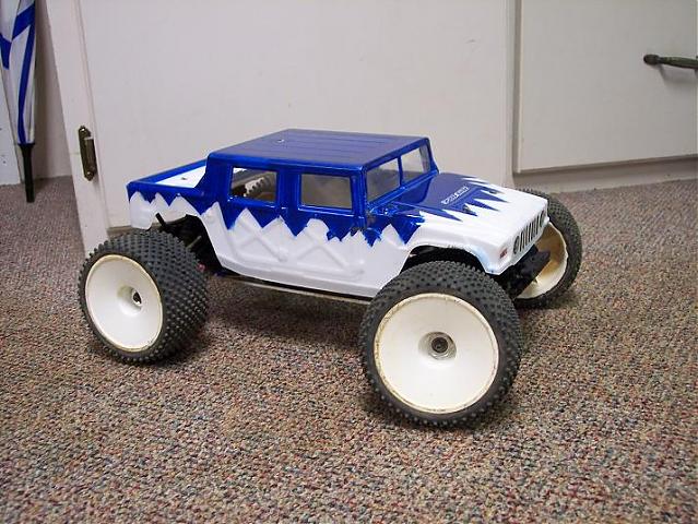

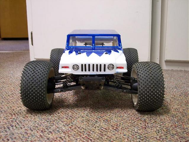

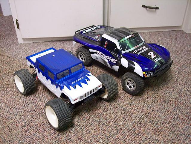

Im rebuilding the LS10 now (all drive and diff cups, and all bearings ) and after looking thru the hobby shop i saw that losi Eight-T body mounts would be perfect replacement/upgrade to the stock ones as these dont break, ive already tested them, also put a new proline hummer body for the stampede on there (i know i messed up the paint job but hey who cares itll be tore up in a month), i also finally used the New era 17mm adapters and bolted on a set of panther komodo LPs on 1/2 offset wheels ,they are 4.72 inches tall and 2.375 wide, i also took off the big part of the front bumper to keep it from digging in on nose down landings and flipping the truck.
it kinda looks more like a little monster truck now than a race truck.
what do yall think?
