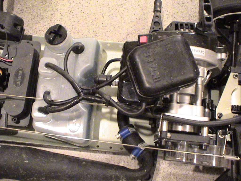

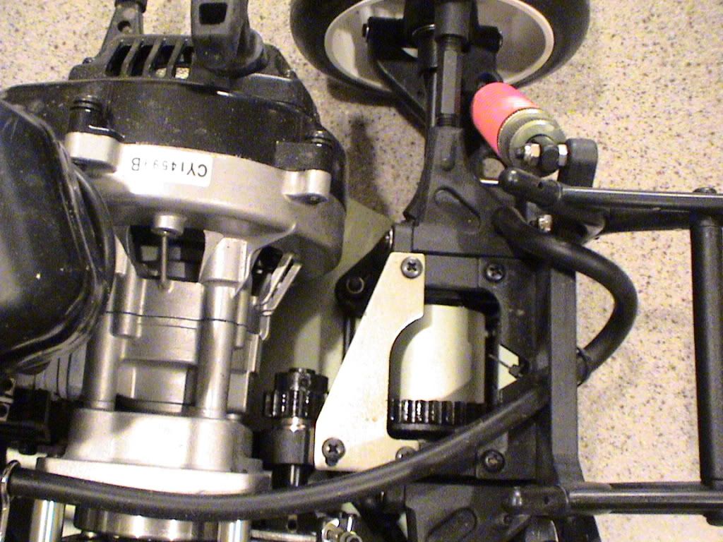

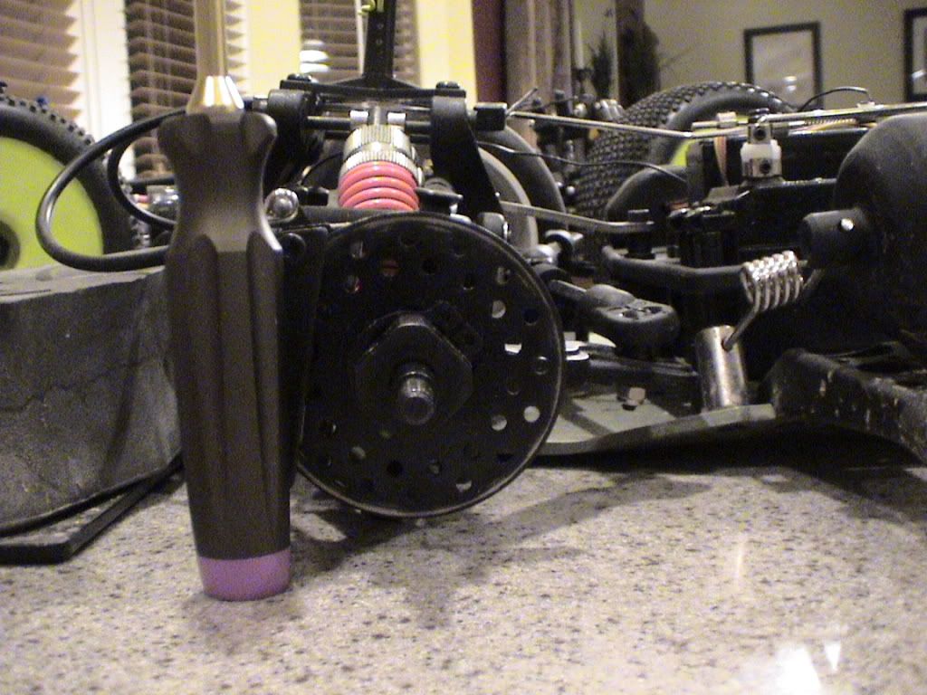

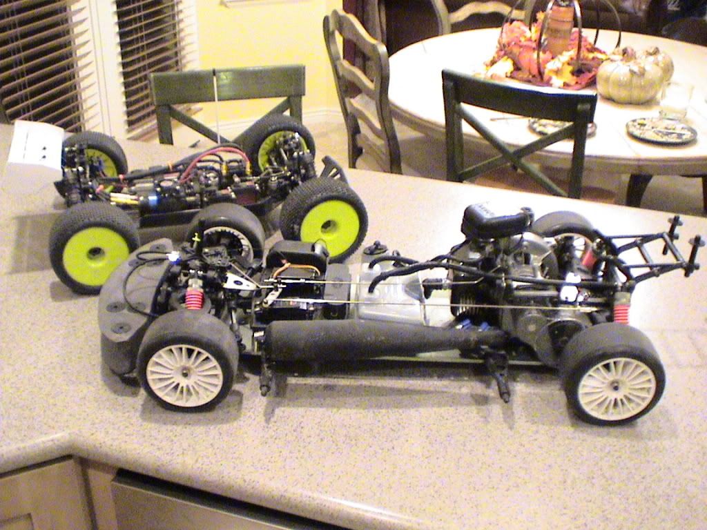

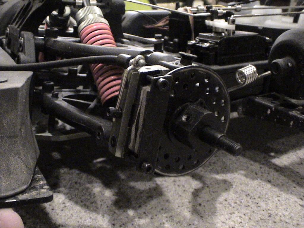

here are some pics of the 1/5 monster. my truggy is in the back to give an idea of the size. the pipe on this thing is huge. the disc brakes (very cool) are massive.
anyone out there converted a 1/5 before or know anyone that has? i am wondering how it turned out and what kind of setup they used. i would love any info relating to 1/5 scale covnersion if any exists.
