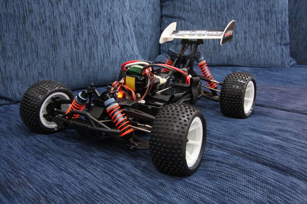

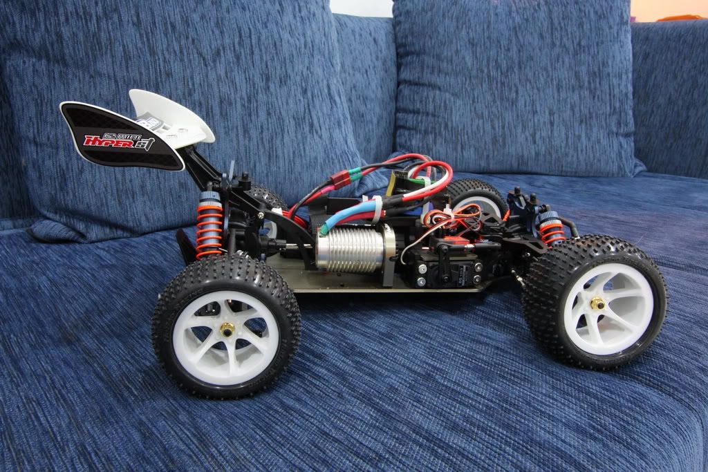

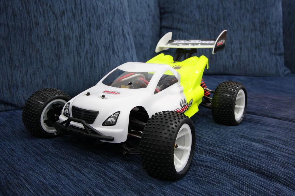

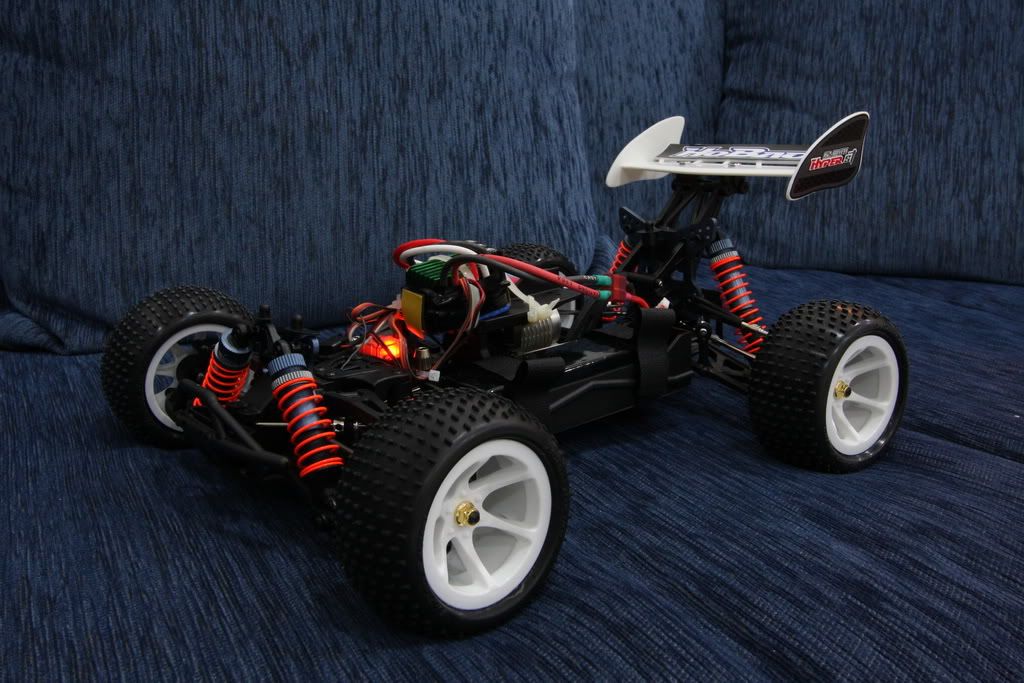

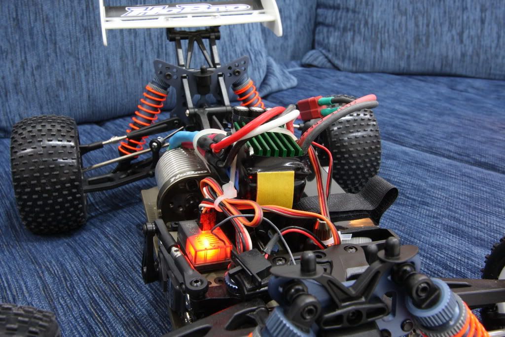

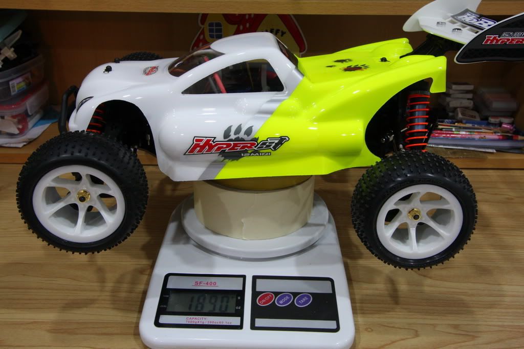

Ok, finally mananged to put the thing together. Had to compromise a little to get it running :
1) MM on 3S
2) 3S 2500mah lipo bought from HK
3) Kontronick Twist 3700kv temporary (Medusa 3300kv on order)
Some pics :
1890g fully loaded
