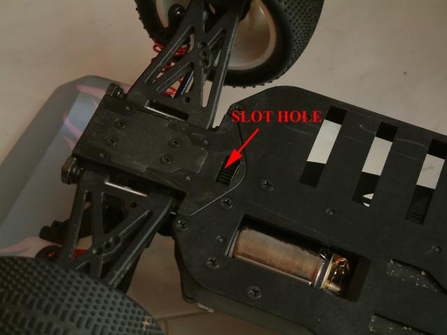

The 48p slipper (with a beautifully machined slipper hub) spur gear is actually exposed to the underside of the chassis via this slot hole located beneath the spur gear. The purpose of the slot hole is so that bigger spur gears can be used. Frankly speaking, I find this a real stupid design. It is like asking for tiny stones or sand particles to go in between the spur and motor pinion to screw them both up. I covered the slot with tape. The buggy needs a real gear cover for protection from sand and stones.

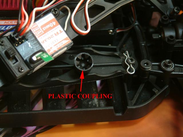

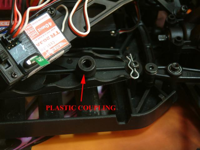

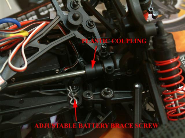

The main (center) drive shaft is made of aluminium and is hollowed out for weight reduction. This is a beautiful piece we are talking about here. It is very well polished. The job of this main drive shaft is to transmit power from the main shaft to the front diff pinion. The main drive shaft is coupled to the front diff pinion with a piece of plastic. This may be a cause for concern as I don't know if the plastic coupling is going to hold up under brushless power. Let's just hope that Thunder tiger will release a metal upgrade if the plastic coupling proves to be a problem.

The battery brace is held on using 2 body clips that clip onto 2 screws that are screwed onto the chassis. So that means that the brace's height level is adjustable by simply turning the screws clockwise or counter clockwise depending on the thickness of the battery that it is going to brace. But do take note that not alot of adjustment can be done due to the limited length of the screw.

Acceleration with this motor is fairly good too. The esc seems to be pretty well made. It only runs at 6 cells nimh or 2S lipo max and is easy to program. Although the esc and motor are somewhat ok in their application, they run hot. After a 5 min run (mostly hard acceleration, full speed then hard braking), the motor tipped at 73 degree celsius. The esc performs better considering that it has been operating under the buggy's body shell with zero airflow. It was around 55 degree celsius. Ambient temp was 32 degree celsius. The stock motor is definitely not going to last under this kind of temperature. Due to the chassis's design, there is almost zero airflow under the body shell. However there is this cooling port (basically a big rectangular hole in the chassis) positioned right under the motor. I've tested a feigao 5407L 3511kv HW80A on 3S with this buggy using the stock pinion. Top speed more than doubled with crazy accleration but the motor temp was only slightly over 50 degree celsius even after a 15 min run. The HW80A was cool to the touch. The buggy was very nimble with brushless power. My SparrowHawk XB is defintely staying with a brushless setup.

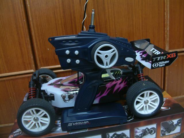

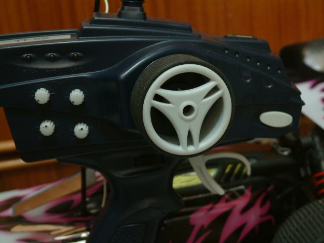

Cheap 40Mhz AM/TX set. Pretty standard features on the TX: Trim, sensitivity and Throttle ATV. The AM radio works fine but AM has its limitations. A brushless setup on the Sparrowhawk XB but the buggy could only go about 50m away from me at the carpark when it started glitching. It will probably do better in a wide open space with no power lines around.
From what I know. FM and 2.4Ghz radios works better with brushless system
compared to AM radios.
