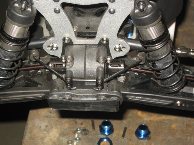

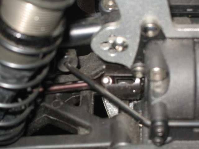

Can you get any pics of the drive cups?
Cartwheels
10.04.2009, 03:08 AM
The left side as you look at the picture is side that has slipped. It is slightly worse off.
I am curious if everyone else's truggy is close to the edge like this. My 8ight buggy is definately not. It's drive lines go further into the drive cups.

My drive shafts are atleast 2mm farther in. maybe they messed up and accidently the wrong part # there at the factory ? i would just disasemble the hub, cvd assembly, and possibly the diff to make sure every thing was assembled correctly. i cant believe losi would do something like this.

Yeah, that's definitley not right. They also look to have a purpleish hue to them (but maybe thats just the image quality). If they do, Losi's are normally black - maybe they got swapped out???
On edit: Now I'm second guessing my color claim...anyone else confirm or deny?

Does anyone have a driveshaft laying around they could measure? How do measure a driveline? Pin to pin?
I suppose it could even be the wrong A arms.

Are the 2.0 A arms wider then the 1.0? I'm starting to think that it may have the the wrong front arms on it.The more I look the more I notice that the front end is wider then the back end.

I got a 8 t 1.0 NIB from Amain and it was the exact same way. Your arms are the 1.0 arms.

I just checked mine, and with the front unloaded (lifting the tires off the ground), my pins sit about the diameter of a pin in further than yours do. With it fully compressed, the pins are just past the halfway point in the slot.

The my shafts are about 13cm from pin to tip (+\- approx. 1\2-1 mm) and my shafts work just as JThiessen described above. and yes according to losi the 2.0 arms are supposed to be a couple millimeters longer than the 1.0. they also look slightly different
1.0 arms
http://www.horizonhobby.com/Products...rodID=LOSA1702
2.0 arms
http://www.horizonhobby.com/Products...rodID=LOSA1704
Hope this helps!
