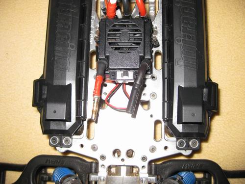

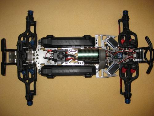

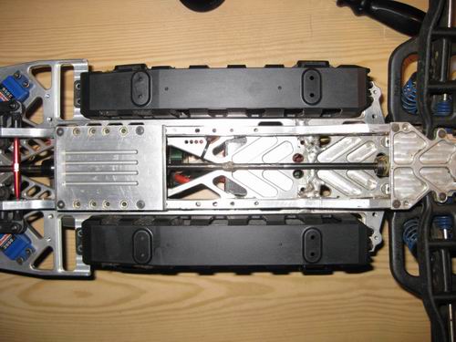

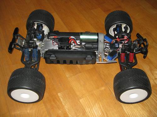

My name is Patrick and i come from Austria/Europe. I want to present my "Bash-Maxx" here in your forum.
My english is not very good, and so i will post more pictures. If you have questione i hope i can answer it.
Now to my Maxx. I took 2 FLM-Chassis and play "FRANKENSTEIN"
I make the Chassis longer for 6,5cm. Now the Wheelbase is 40,5cm (around 16") and i make the Savage Flux Lipoboxes on the Chassis. So the weight is lower and the Maxx is very easy to drive. Not always lying on the back after a fullthrottle an no rolling to the side when driving corners.
The maxx also have FLM Combo-Bulks, full RPM suspension and a CC Combo with 2200kV which i drive on 4s Lipo.
anough words, now to the pic´s.
greats from Europe
pako1979

I've thought about doin this to an FLM chassis to lower its CG... Just hard for me to justify cuttin up a perfectly good $100 chassis ... Any way you could post some close ups of how the boxes are mounted? Maybe some vids too ...

Nice build man... lowering the FLM Chassis transforms the Maxx into a entirely new truck... what shock/spring combo are you using now?

Thanks for your congratulations. (From the Masters of the forum it taste very good)

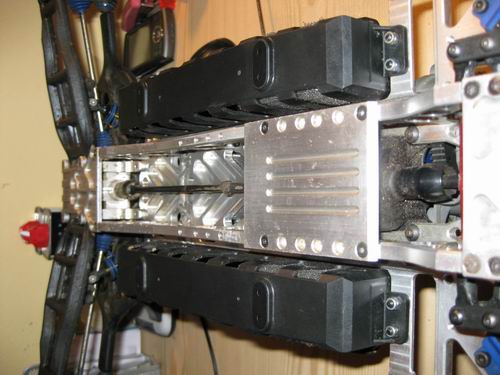

I hope you can see, that the conversion is done very well and not crapy. The most work was he thinking about how i can make it. This take about 2 mounth, the working self was only 5 hours.

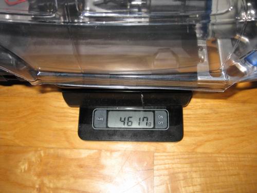

i´m proud of the weight. 4.617 gramm (about 10.20 OZ) without Lipos
here are more pic´s

Original mods indeed, good job
I like the welded rear center driveshaft
I have a FLM chassis as well, I found another solution to protect the packs and to fix the pack's sliding problem : RCM custom trays
Maybe Mike (RCM owner) can make a rear center driveshaft for you, if yours doesn't last
A vid would be cool !

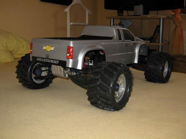

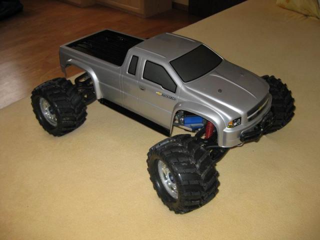

Now it was time to make a nice Karo and put on better looking wheels.
The karo is from an XTM Mammouth an have 39cm wheelbase and fits perfect. Wheels are PL Masher 3.2 with 8-shooter beadlocks.
greats pako
