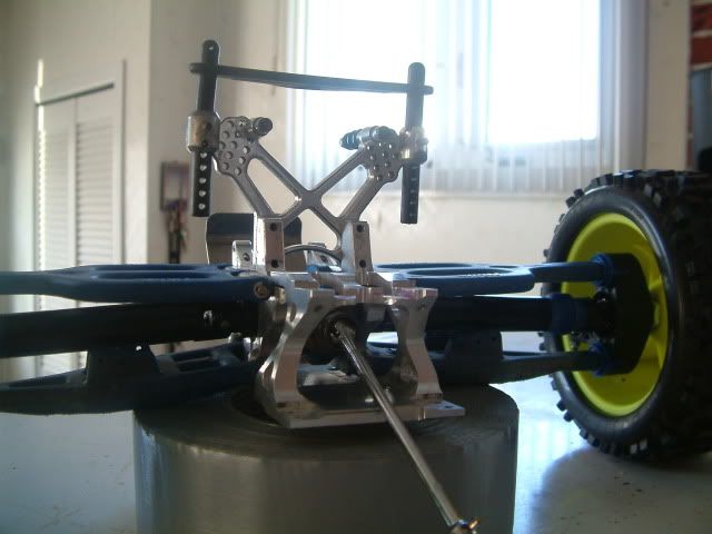

No I put it in the back. The front is KD kit ( I use the front only)
Right now, it look like this!

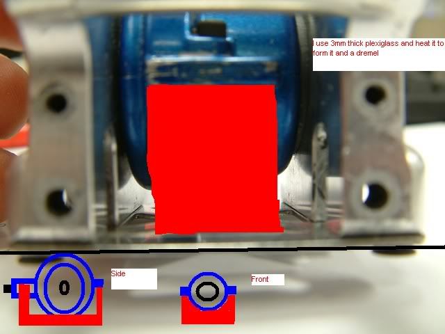

After breaking 3 diff collar, I made this
markusb
03.23.2010, 01:32 AM
Nice mod you got there! The plexi is a good idea, I'll steal it from you :)

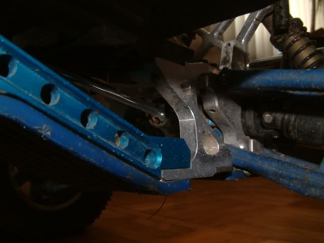

03.23.2010, 07:24 AM
Here is some new one!
