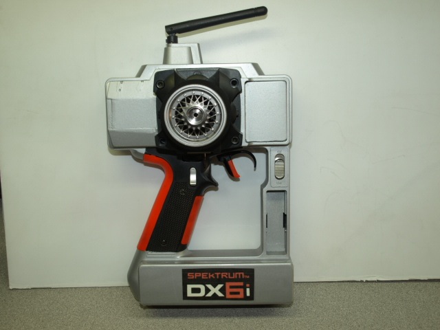

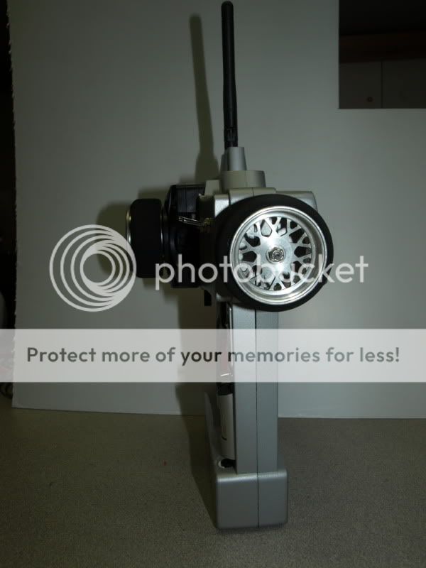

I am working on converting my Spektrum DX6i into a Pistol grip radio case.
One other person I know of that ran with my idea a year ago has completed his (Brittan) and myself and onather are building ours. As well as other people taking various other 6ch systems and installing them into TQ2 and TQ3's.
Just wondering if any of you are doing the same ? ? ?

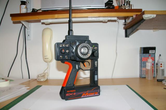

last picture is a completed DX6i conversion
Here is mine so far
No switches or electronics just yet.

WOw , tell me more on your 3 custom mixes ? how did you gain a third mix?
Im curious as to what all the switches will be used for now? Most of them are dual rate switches for ailerons, rudder and elevators on a plane, not that much use on a car I'd have thought ( except for steering ). Theres also the throttle kill switch for a gas engine ( handy on a baja maybe? ) , the bind/trainer switch and the flaps/landing gear switch which has no neutral setting with the stock switch, but it coould be modded to act as left-middle-right or something..
The possibilities are almost endless. not sure how the throttle cut could be reused since you cannot assign it to anything else.We dont just use the DX stock switches, we make up our own depending on the need of the model, like take 2 switches and turn them into a 3 way switch, or make a switch that turns on or select between two different control methods. or even turn 2 different switches into 2 momentary buttons.
So yeah, I guess my question is why spend ~$150 on a stick radio + $xx on a large enough pistol radio and swap the guts over, when you could sell the pistol radio and get a pretty good brand 2.4ghx radio with plenty of channels for the same money or less? Euragle have nice radios, as do a fair few other places if you are after saving money..
Im curious mainly...
Whats this " Pretty good 2.4 with (? plenty of channels ?) for the same price as what ?
$100. on a DX 6ch 2.4 is dirt cheap, $10-$30. on a old radio case= you get a custom 6 Channel Pistol radio that does not exist. Run your Super custom Crawler, your 2.2 Comp Crawler, offorad SC, Onroad car, Heli and plane all from a Top notch 2.4 DSM 2 system for under $200.
How do you beat that ?

SpeedAssault
SpeedAssault's Avatar
Posts: 311
Join Date: Nov 2008
Location: CA Bay area
03.27.2010, 12:08 AM
Sounds great Chadwrks , gota a thread ?
MIX will be my Rudd-Ail (Crab steer)
Rudd D/R will be Rudd-Ail (4WS)
1/8 Scale buggy
Ch-1 Aileron = Front Steer
Ch-2 Throttle = Throttle
Ch-3 Rudder = Rear Steer-proportional
Ch-4 Elevator = 3 way switch 4WD, 2WD, DIG
*Ch-5 Gear. Avail (lights)
*Ch-6 Aux. Avail
Mix = Silver momentary on grip 4 Wheel Steer
Ele = Silver mom above thumb Crab steer
BERG:
Ch-1 Steer
Ch-2 Throttle
Ch-4 Elev. DIG
DUAL ESC:
Mix =silver mom Front throttle 100% / Rear 80%
Mix 2 = silver mom Rear throttle 100% /Front 80%
OR
Possibility Mount a Throttle trigger upside down in battery tray and use pinky to operate
Other 1/10 Cars/Trucks
Program for Standard 2/3 channel operation
1/5 scale On-road
Ch-1 steering
Ch-2 Throttle
Ch-5 Front brakes-
Ch-6 Rear brakes
Heli/plane = Umbilical cord back to DX6i Stick and stock switches

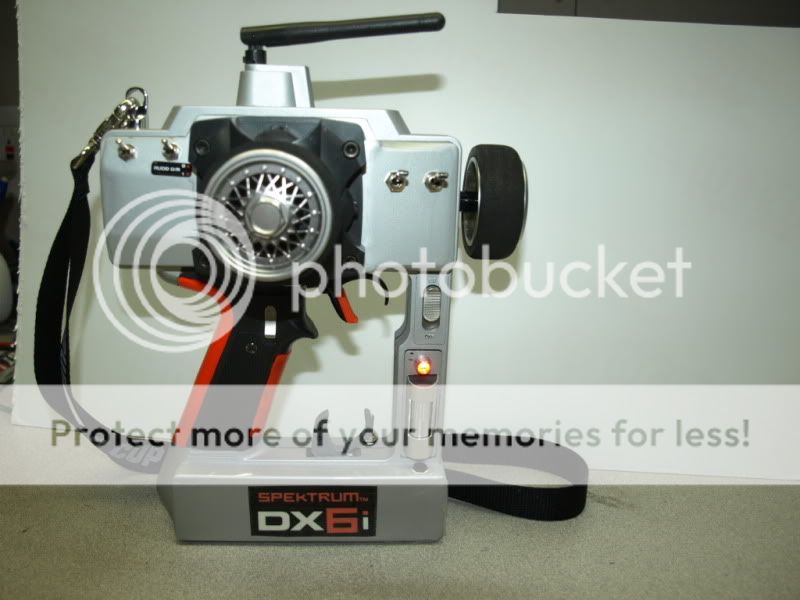

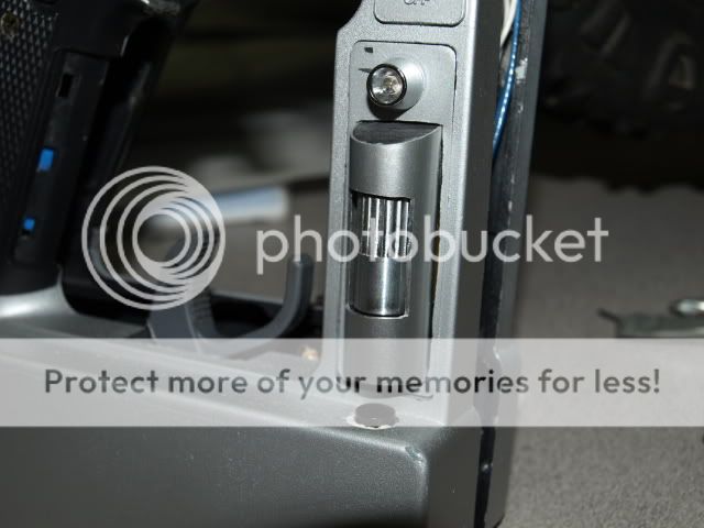

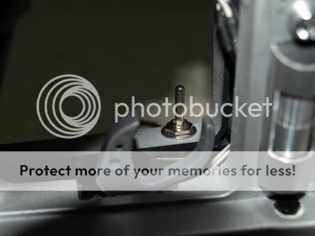

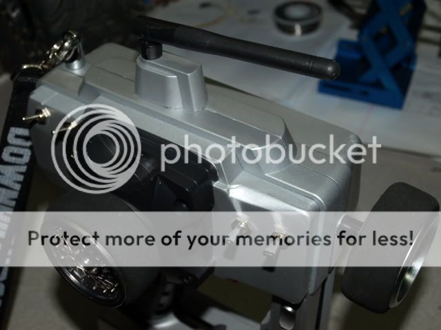

04.12.2010, 11:13 PM
Just about all Done !
Ch1 Throttle
Ch2 Front steering
Ch3 rear steer
Ch4 3 position switch for 4wd, 2wd and DIG
Ch4 2nd throttle trigger for DUal ESC crawler
Channels 5 and 6 on the right
Elev DR and Rudd DR on the left

brushlessboy16's Avatar
04.12.2010, 11:29 PM
WOAH! KICK ASS build! I could never use it but its awesome!
simplechamp
simplechamp's Avatar
Posts: 1,884
Join Date: Jul 2009
04.13.2010, 05:39 AM
I think it could use a few more wheels and a couple more triggers....
Just kidding! This thing is very neat, way to go on an awesome and unique project.
nativepaul
nativepaul's Avatar
Posts: 522
Location: Sussex, England.
04.13.2010, 07:53 AM
It looks like an ergonomic nightmare to me, I will consider doing this to my Futaba 6EX stick set just as soon as I grow a third arm for the other wheel, but well done on the build, its thinking outside the box for sure.
I saw a channel for Dig mentioned several times, what is Dig?
Xray XT8, 1518, MMM, 4s5Ah.
Lots of boats.
fastelectrics.net
04.13.2010, 08:35 AM
It's a crawler thing...
Dig is when you lock the rear wheels and drive with the front only... the wheels "dig" in...
Burn is when you lock the front wheels and drive with the rear only...
