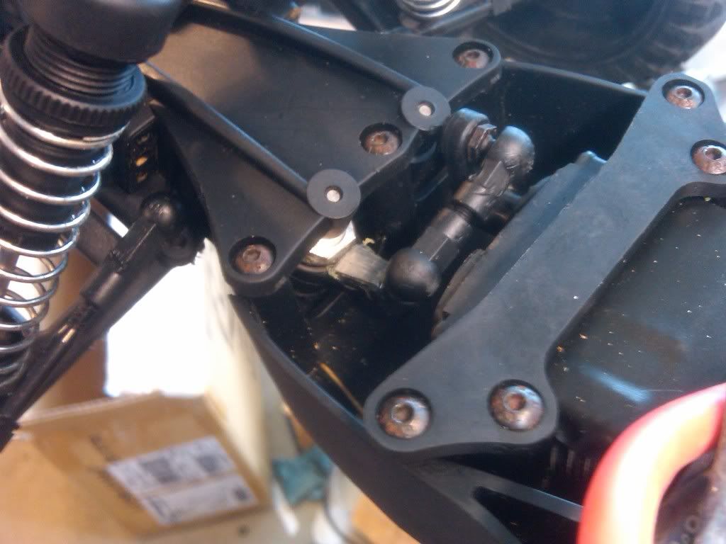

Love the truck so far, But is there any fix to the loosey goosey steering assembly the belcrank wobbles like a wet noodle...Tempted to make a little brace and epoxy it in.

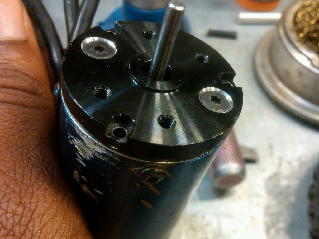

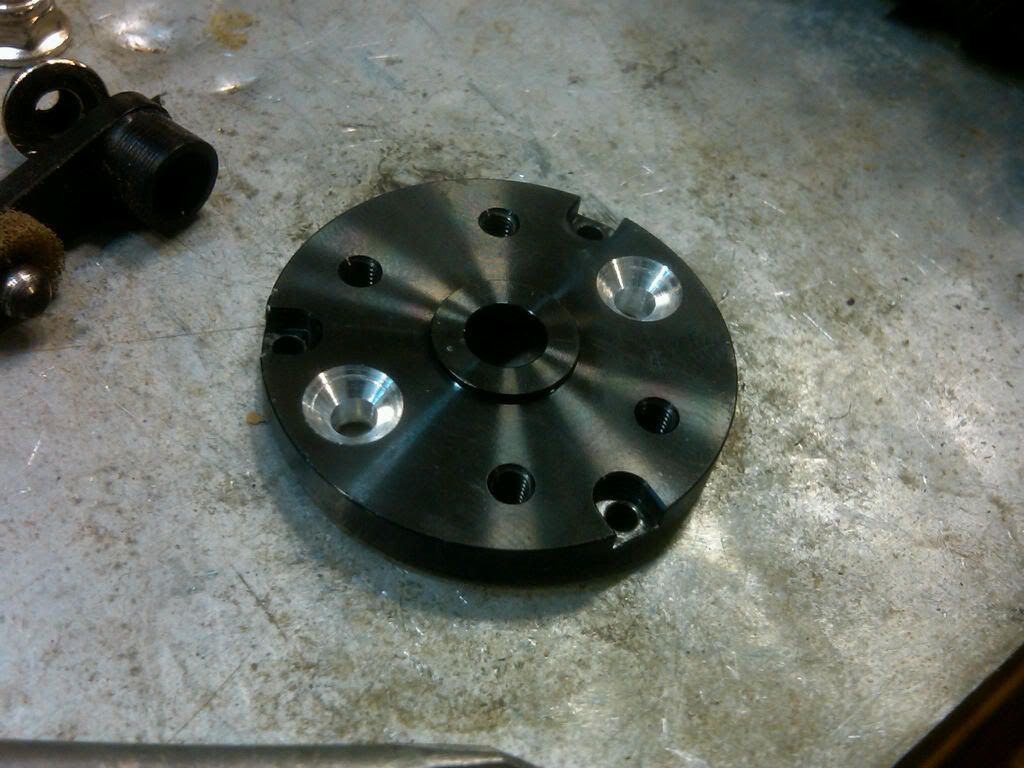

I sat out in the heat all day to get this truck where i wanted it!. First thing was the motor, which ended up being the last thing when I went to put the gear cover on, the motor shaft stuck out way too far... I ended up taking a front endbell off an old fried motor, drilled and countersunk 2 of the holes to make a spacer that would sit flush against the motor plate. With a bearing installed in the spacer it helps support some of the motor shaft load.

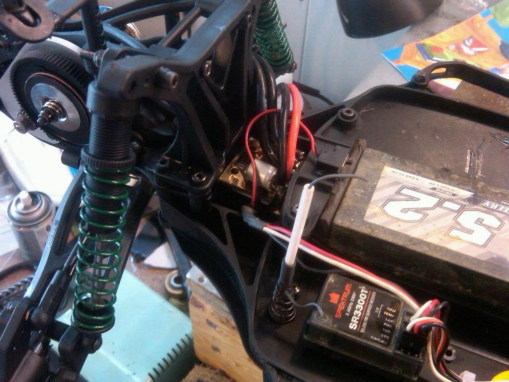

Here it it installed

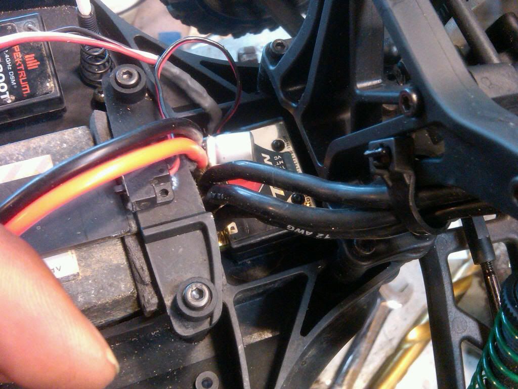

Got a used tekin R1 esc in today and found that it fit behind the battery box nicely.

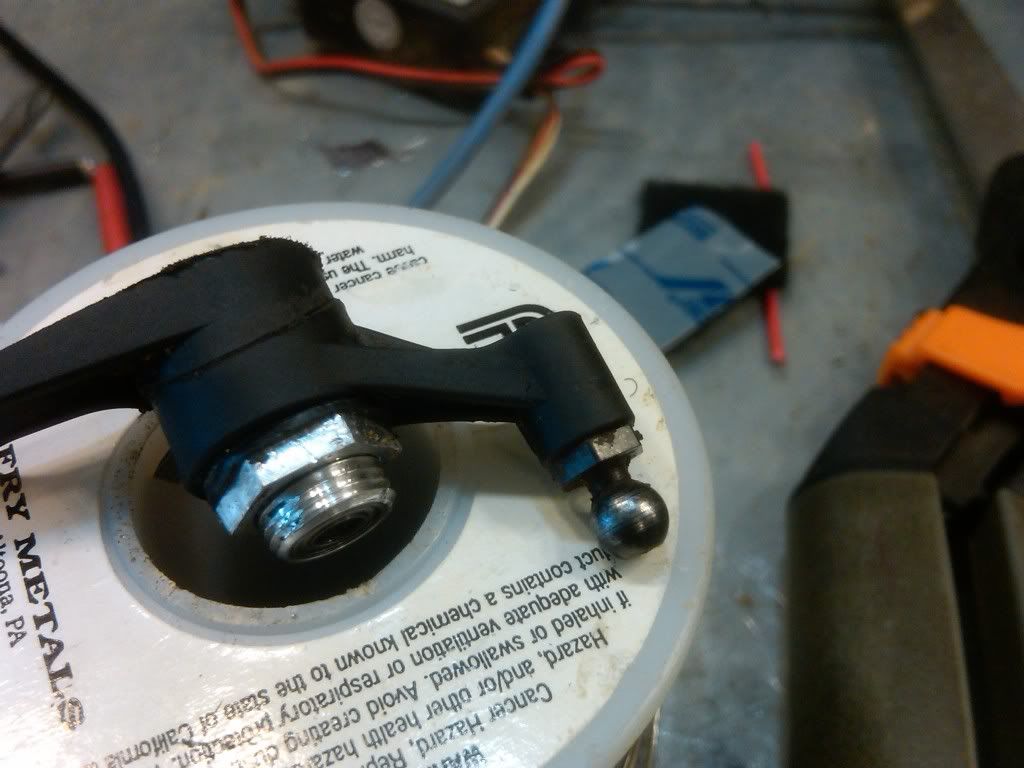

I found the cause of my steering problems, the boss where the ball stud is mounted is cracked and was allowing the stud to flex under load.
I used a small peice of plain ol' aluminum sheet metal in the shape of the arm and two part plastic epoxy to bond everything into one unit. there is no more flex!
Esc tucked away
