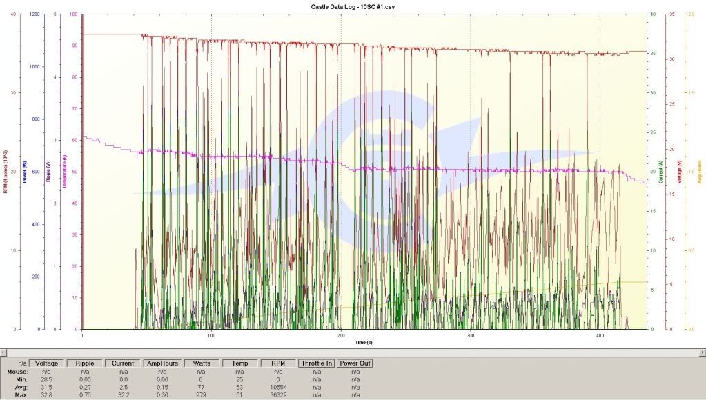

02.27.2011, 06:20 PM
Just had THE MOST AWSOME rc day EVER!!!
I'll post up pics and maybe a video with all the mods and changes with a data log later today, but in a nutshell this thing is now frigid awsome!
A short teaser, is it's running 8S 1300mah lipo's, a neu 1515/2y, and a Phoenix ICE HV 80 Esc. The data log blew me away, max of 36amps (970watts) 0.76v of ripple and used ~300mah in 7 minutes. The ESC actually got colder during the run (low ambient temps) and the power is good enough to pull wheelies and ballon the tires.
More to come in a few hours...

02.27.2011, 11:46 PM
DrKnow65
DrKnow65's Avatar
Posts: 998
Location: Colorado
02.28.2011, 12:14 AM
[YOUTUBE]Q36hTYVOde8[/YOUTUBE]
Here's a video we shot just before dark, tires didn't do too well in the grass. Had a good flip mid video and ended with a broken steering post.
But when the truck's on the street you get a good idea of the performance. Only 29.6 amps max during this run and ~390mah used in 5 minutes.
The grass really boggs it down.
