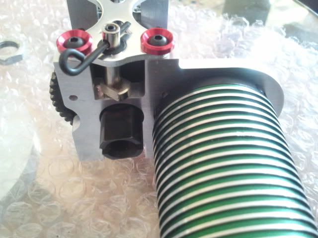

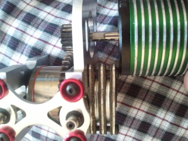

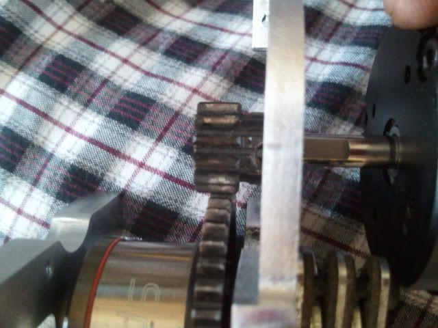

Need some quick advice regarding my pinion sitting on my motor shaft with the brake assembly on the new motor mount.
If you look at the pics below...
You can see that with the dual brakes fitted, i will need roughly a 15mm motor spacer to push my motor away from the mount in order to clear the brake assembly.
Dejan is making the custom size spacer for me...
But this means the pinion will have to sit half way off the motor shaft too.
Is this a very bad idea? considering im running 9s? Should i just go with a decent single brake setup in the front?
This does seem like a bad idea, and i should really run a single brake disc and pads instead.
If so... What are the toughest brake pads and discs out there that work with my spider diff axle and can handle high temps with no fade???
THANKS

sorry guys, i didnt make it clear...
I wanted to run dual discs front and single disc on the rear :)
What you are looking at in the pics are my front brakes...
BUT
as the motor is in the way, and i need a spacer to pull the motor from the mount so the brake assembly has space.
So it looks like i can only have one brake disc on the front, unless i use the tekno long shank pinion (but i do not like the idea of only being able to use a single type of pinion) ....
i can still have two on the rear, but as we all know all the braking is basically done with the front... so only one will be necessary....
So as i can only really have a single disc on the front, im wondering what are the best discs and pads that will work for my applications???

The main issue with using a long shank pinion is increasing the load on the motor bearing. The forces aren't exactly huge, but a heavy truck with 9s and a long shank pinion is going to see more than average forces at the bearing. Regular inspection and/or replacement of the front motor bearing would be recommended. Where the setscrew is on the motor shaft doesn't make any difference in the amount of force at the bearing. Its where the gears mesh that determines the leverage and amount force placed on the bearing. The fact the pinion is an odd size is another drawback though.
