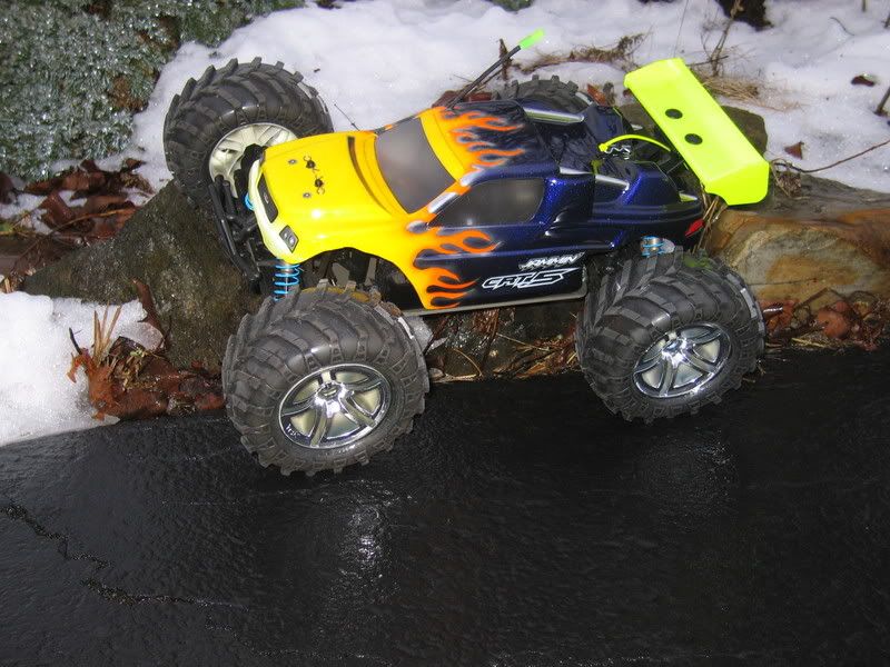

I also have a set of mashers for mine, altho its impossible to keep the F wheels down. One trick I do like with the mashers are to mount them on the TRX 2.8" rims. I cut the beads off, then mount them inside the new rims. Same size, but much less ballooning and a bit better handling.
