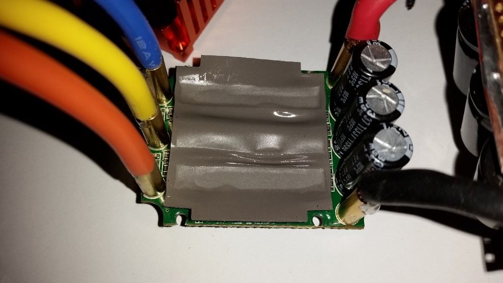

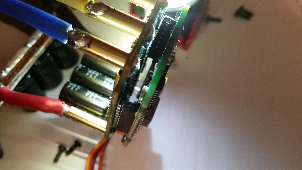

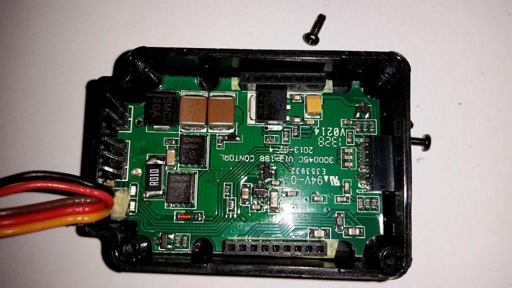

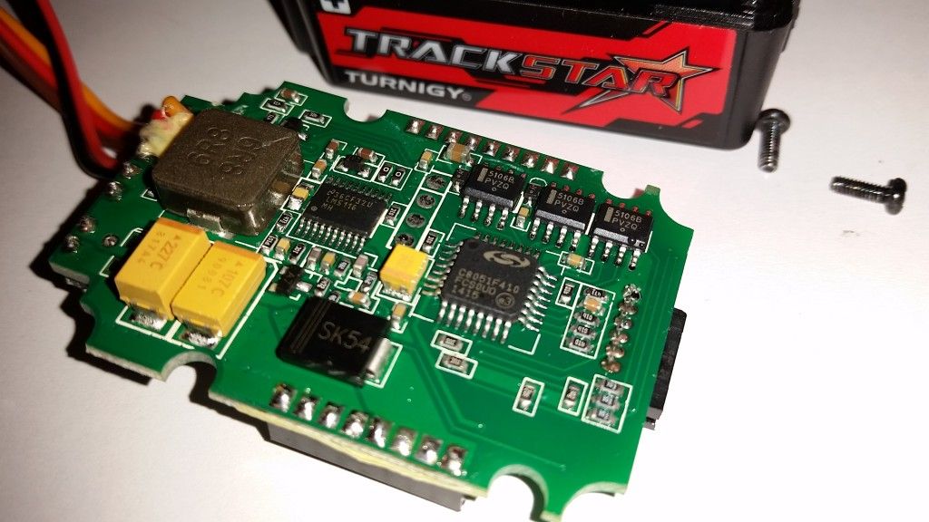

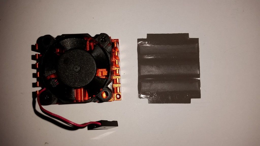

Wanted to share some pics and infos about the Turnigy Trackstar 150A Gen2 ESC I recently bought.
The plan is to run the ESC in my XO-1 powering the Turnigy XK5682-900KV motor.

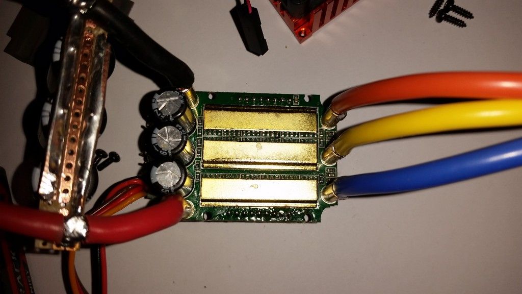

Generally, the ESC seems to be okay from a build quality perspective as far as I can see.
What's not so nice is, that the two PCBs are not soldered to each other, they are using pin-connectors. Not sure if that matters only in theory, but I guess this could be a source for problems, especially with offroad usage.
From a cooling perspective it's not too good IMHO. The FETs on the upper side have heatsinks that are soldered to the PCB, but there is air between the FET case and the heatsinks, so the heat has to travel through the PCB and then to the heatsinks. The lower FETs don't have any heatsinks at all, they rely on the PCB cooling path. On top of the heatsinks there is a thermally conductive pad which is needed to compensate for the difference in height of the heatsinks. On top of that, there is the orange heatsink.
The heatsink is screwed on from the underside which causes the PCB to warp a little from the pressure.
But that is actually a good thing if you want to improve cooling yourself, since everything can be removed. On Mamba Monsters for example, the Heatsink is glued to the FETs, impossible to remove.
Here are some pics:

From the looks of it, the bottom un-heatsunk PCB is the brains, so should generate little heat. I've seen lots of boards connected with pins like that, and as long as the case holds them together, there should be little concern even for off-road use.
And about the dual heatsink thing: FET packages are relatively poor at transferring heat, which is why they soldered the heatspreader to the PCB - which will pull heat from the FET faster than any HS on a plastic FET case. Then, they use the main large heatsink to dissipate the heat pulled from the heatspreaders. And even though the FETs on the underside of the PCB are not directly heatsinked, the large traces should be more than sufficient to transfer the heat upwards. IMO, not a bad design to be honest.
A better option to me would be to use FETs that have a low rdson and a high slew rate - those two factors alone can result in less heat to be generated in the first place. Those FETs have an rdson of ~3mohm and a rise/fall time of ~50ns. Not sure how those figures compare with FETs of other current generation ESCs, but that's something to look at.

The Tekin RX8 has the 2 boards also connected by a row of pins.
I never had a problem with that and I assume that Tekin has done it's homework?

I think that its not a problem that the two layers are sticked together with pins, have seen that a couple of times.

Well, if that cooling design isn't bad at all, then I'm going to try it like it is :)
Not sure if it's really necessary to use lowest-resistance FETs, atleast Uber on rcgroups says it's not needed when ESCs are properly designed. It's just a few watts, if you have the cooling to remove the heat that doesn't matter I guess (?)
Regarding the pin connection: Maybe it's just a theoretical problem, but I think it is a possible cause of failure when run offroad with lots of vibration, shocks and dirt. Those connectors are designed to be used in computers and other stuff that doesn't get abused in the dirt like RC cars do.
The cap bank is selfmade from a piece of "Lochstreifenplatine" (not sure what that is in english, that kind of circuit board you can buy for making your own circuits).

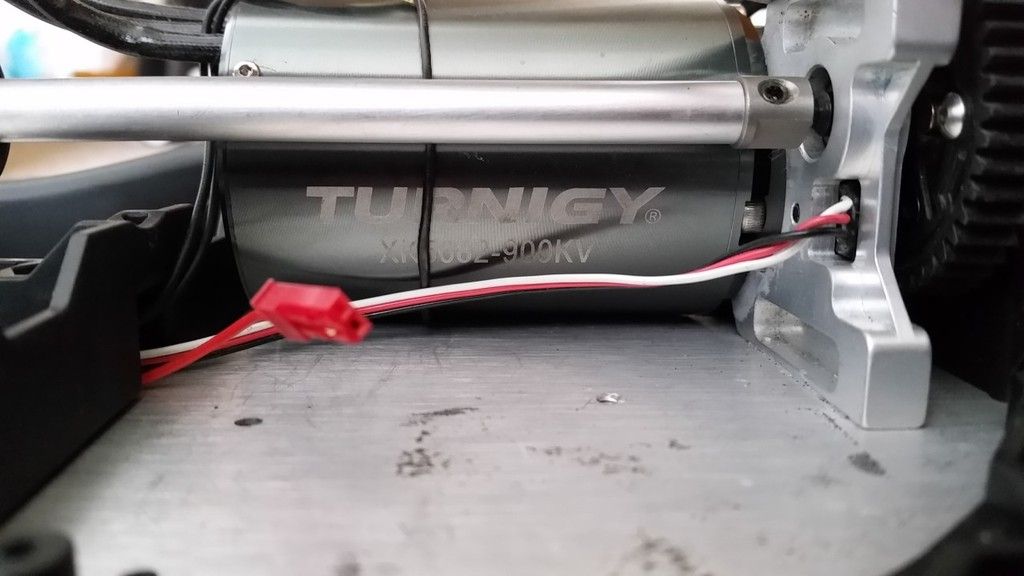

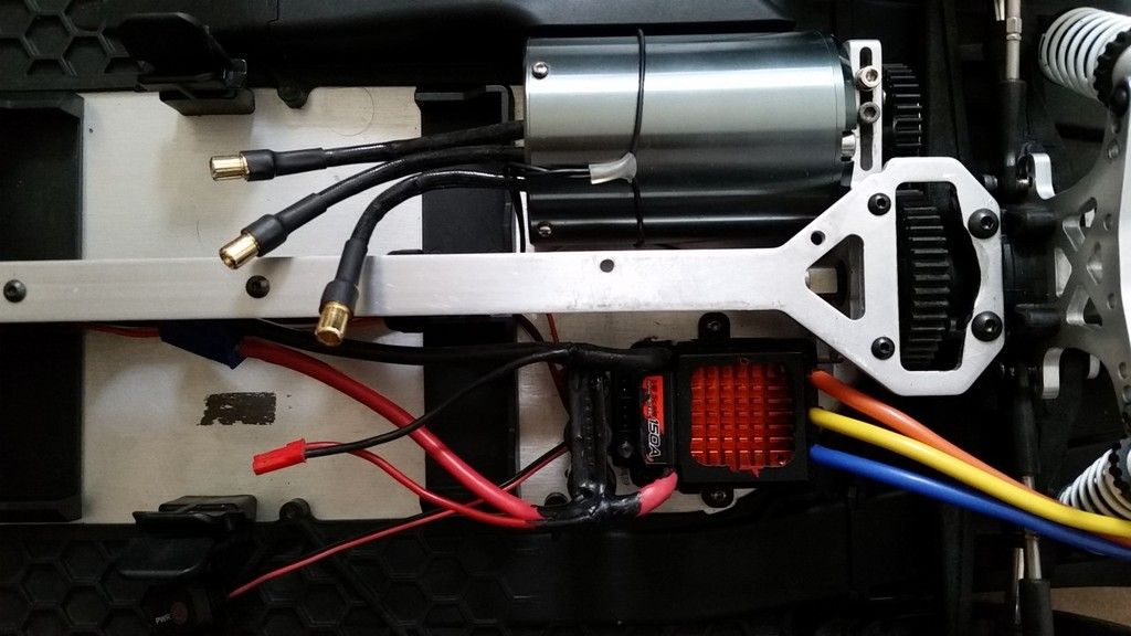

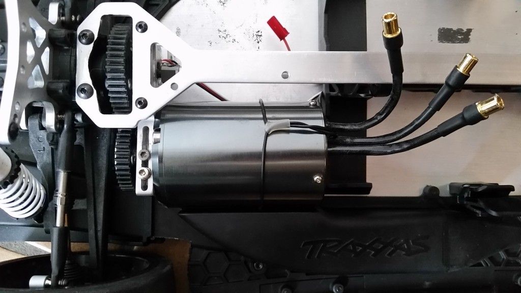

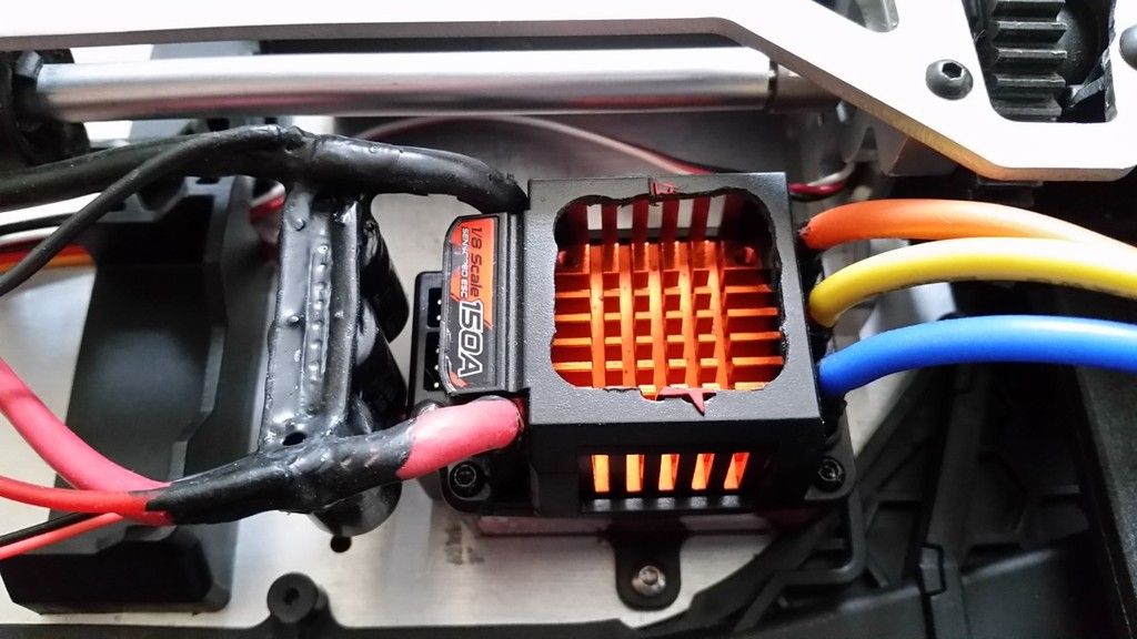

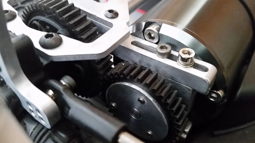

Finally put the Trackstar ESC and the Turnigy XK6582 900KV motor in the XO-1. Luckily, the 56mm motor fits without any special motor mount, just had to drill two additional holes into the stock mount. The ESC mounting plate also fits the holes already in the chassis
Added three 1000uF 35V Low-ESR caps and removed the cooling fan (wanted to add bigger fans later). Used the 46t XO-1 spur gear and a 36t Revo spur gear with an adapter as a pinion gear. With the 4.29 inch XO-1 tires that translates to 112kph/h unloaded with 3.7V per cell.
Well, it didn't turn out too good. When I switched on the Traxxas TQi, it wanted me to do an update. Did that. Then, suddenly during the updating process, the TQi decided it was a good idea to send a full throttle signal to the ESC. Quite scary. Luckily, I always put something under the car so that the tires were in the air. Disconnected the battery cable then and re-did the update without ESC connected using an external battery pack to power the receiver.
Powered it up again, and tried to run it. It coggs like crazy, it's almost impossible to get it moving. Motor, ESC and cables stay cool though. Not sure why that is, hopefully it's not because I damaged the ESC by pulling the battery lead when it was running unloaded full throttle (?) Or maybe it's just not "compatible" with that Turnigy motor? I guess I have to try it with another motor ...
