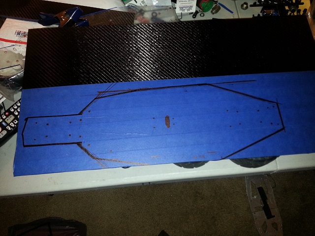

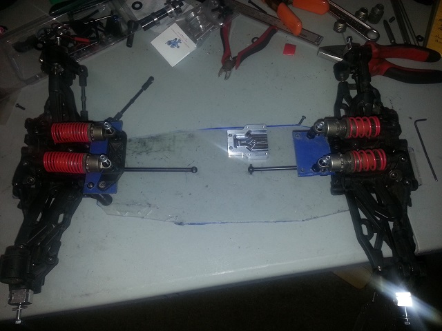

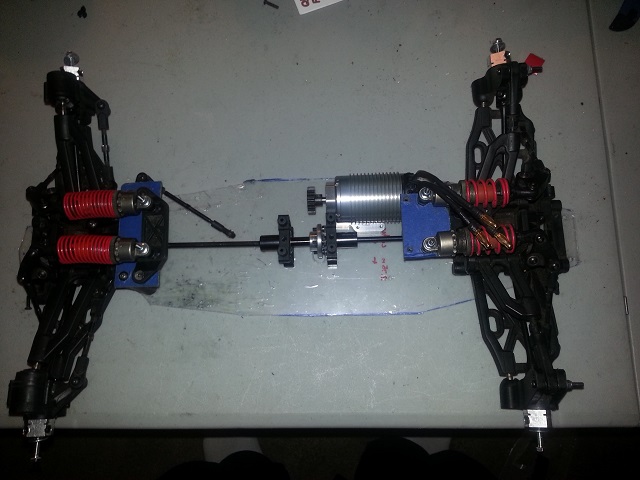

I had a spare DM-1 Pro roller chassis laying around and decided to cut it down to a 360mm wheel base for a new speed run car. The DM-1 Pro had a wheel base of roughly 379mm so I cut 19mm out of the middle and mocked up a chassis template using plexiglass to make sure to line up the screw holes properly.
