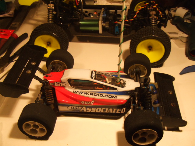

The RC18B is a onroad only car I have been running a 4s 2100 Maxamp pack in for almost a year now with a variety of motors and the driveline has held up great it's basicly a RC18B ft kit with a carbon chassis and MIP diff's with CVD's in the front and it's been over 80mph with the 6800 Mamba on 4s I'm hoping to get it over a 100mph by July for the worlds fastest RC challenge.:032:
Runtimes with a 2100mah pack?
8000 Mamba = around 30min
6800 Mamba = around 45min
5700 Mamba = around 55min
Wraith 7k = around 25min
Name:	e crt 046.jpg
