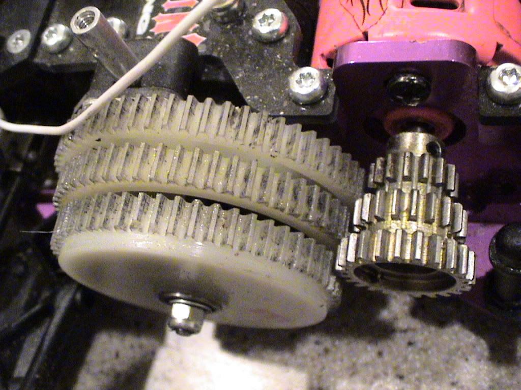

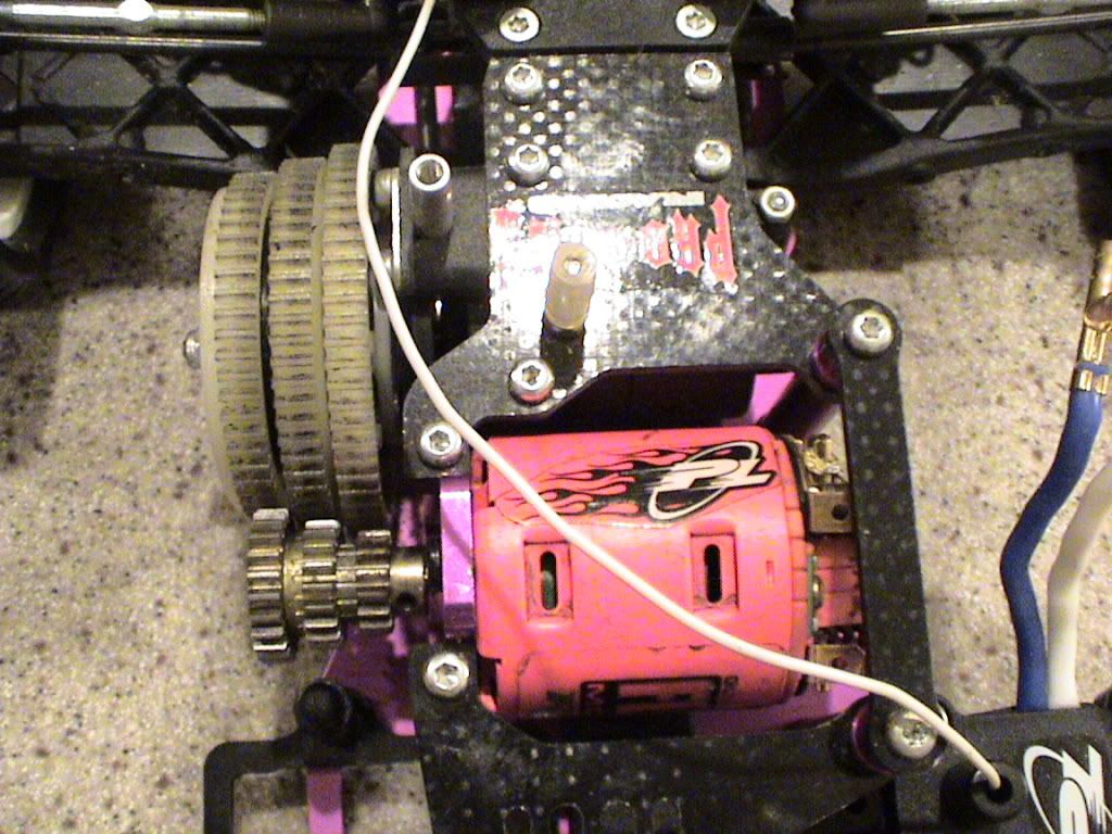

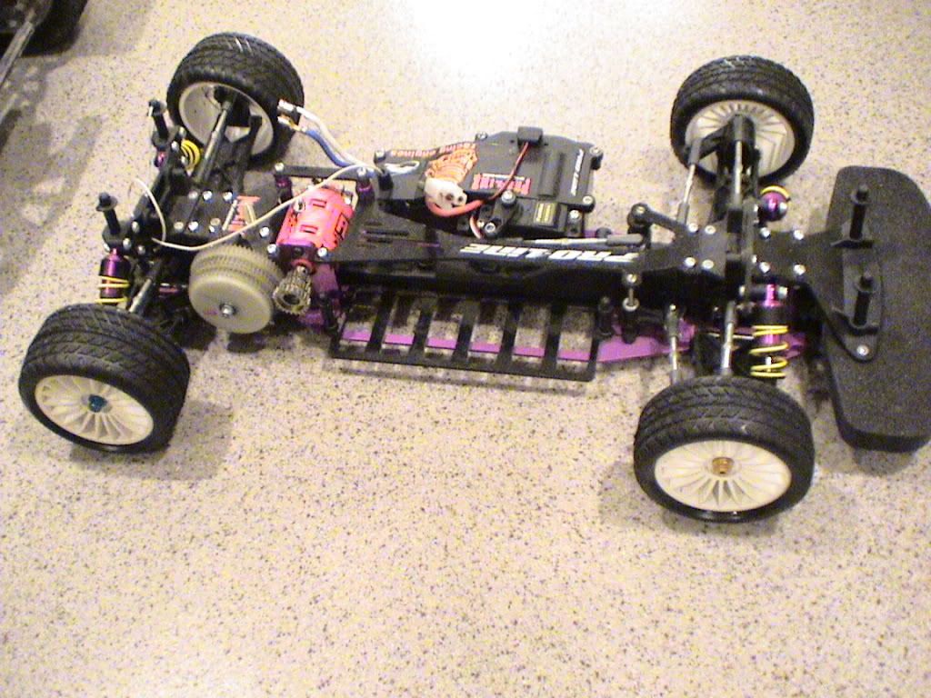

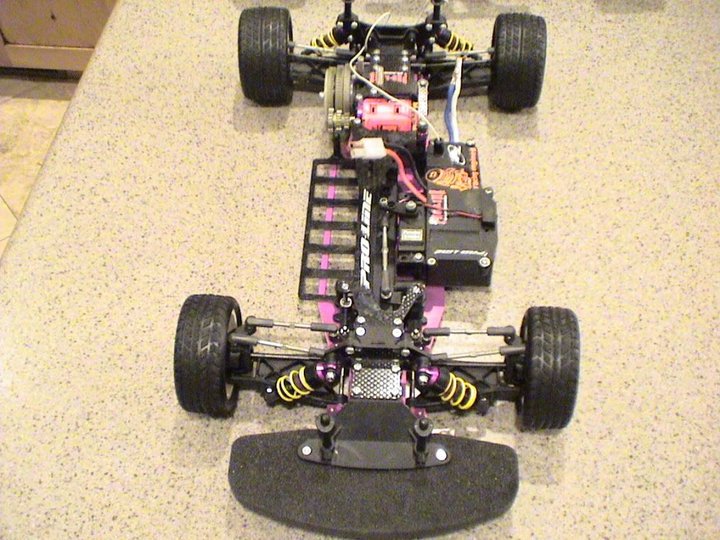

i will be sure to post lots of pics but it might be a couple of weeks before i begin work on it now cuz i just got an 1/8 scale Schumacher in the mail yesterday that i have been waiting for for 2 months. i have already bought all the parts and stuff to convert it and so i am going to build this one first. it has a 3 speed trans so i am hoping to make this 100mph+ car. should be fun. it is electric already so doesnt need any converting....just some major improving. here are a couple of pics. it is the Shcumacher Menace GTRe. when this one is done i will start on the 1/5 and be sure to post lots of pics. thanks Team for all the pics and info on 1/5 conversion. sounds like i need to seriously look at the 2200 series Neu motors. would love to see any other 1/5 stuff out there. when will we see the first Baja 5T conversion? anyone, anyone????

Good luck with the GTRe. I had one and thought it could do with quite a bit of work to be competent for high speed. The center brace limints battery height, mine had alot of drag in the belt setup, and the barkes just did not work well. Plus that big electronics box is kinda dumb, it would be better to have a battery tray on that side too. And you motor choice will be a bit limited due to the special 3 gear pinion with 1/8 bore. Maybe get a medusa 50mm with 1/8 shaft, but I think a larger motor would be required to run 100mph...
Sounds like an interesting project, I have only seen a few GTPe floating around, I had mine well over a year ago. It was brand new when I got it.

here is the plan: 60mph car finished in the next 4-6 weeks. i would like to say it would be done sooner than that but just being realistic when i consider the money and time.
does anyone here know where to get a 8mm shaft pinion gear that will mesh with these 1/5 scale gears?
hey pimp,
so do you still have your GTRe? i have heard that these are pretty rare. at least that is what the guy told me that i bought it from. but i noticed you can still get them on the schumacher site.
here is what i am going with. i have looked at all this stuff and it all fits pretty well.
Mamba Max ESC
Castle 5700kv motor (1/10 of course)
losi 3200mah 3cell lipo (would like to run a thunder power but wont fit....maybe with some mod i can make it work)
2 jr9100s servos
many alum and titanium schumacher upgrade parts
as for the 100 mph you may be right. many of these 1/10 brushless motors push the RTR trucks at 70 mph out of the box so i figured that this GTRe with the 3 speed would do 100mph+ with those extra gears.
i assumed that 3rd gear would be very tall and that 2nd gear would be similar to the gearing of the single geared RTRs that do 70mph.
well, after looking at the gearing it appears that 3rd on this GTR is about the same as the RTR stock pinion and spur setups like the Rustler and the Losi speedT. anyway, i may just have to scrap the 3 speed trans and come up with something different. will just have to wait and see. But i know these motors could do 100mph with the right gearing. if my Rustler VXL had a 2nd gear....whoa.
