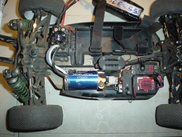

its just a stock losi 8ight E
running a 13 tooth -pinion stock spur
battery is 5s 3700 enerland
the track is really a small 1/10 scale indoor track. on a 180 turn sometimes if i slide the car and it stops at the apex it will cog trying to start out.
my 808 with mmm and 1512/1.5y is smooth as silk in the same turn
