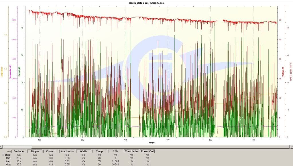

Forgot to click the Wattage button, it maxed at ~1100watts. Ripple was 0.76V max.
41 amps peak, 36K rpm, 600mah in 12 minutes, and it got COLDER during the run Truck is right at 6Lbs track ready.

Thats sweet on 1300mah cells.

I love having 8S 40/80C lipo's that weigh less than a 2S 6500mah battery... and last twice as long (ran the truck against a 2wd slash, he went through two 2S batts).
Efficiency is the name of the game, and I'm able to lay down some serious power.
Its running a 13T pinion now. If I throw a 15 in it'll up the amps, but no 2S rig will keep up.
