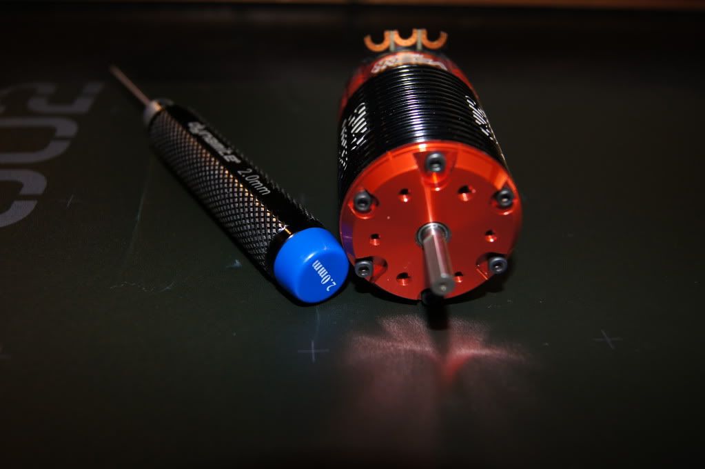

I finally got the Viper Buggy motor in. Packaging is excellent and delivery service is top notch. I will post more once I get some free time.
It's rated at 1800kV
2 Pole rotor with 3 slot stator
5mm Pinion shaft
7.35mm Rotor shaft cut down to 5mm in the front
4.47mm Rotor shaft in the rear. So rear bearing is smaller than the front.
45.04mm Magnet length
13.82mm Magnet diameter
The motor feels notchy.
The back cover is plastic.
The sensor is replaceable.
The rear has a rubber seal.
Assembly is very good.
Front motor screws are 2mm and the rear are 1.5mm hex.
Heavy copper tabs.
Front has shims and spring assembly.

Did a test run today. It's nite and still 100F outside. The motor is what I expected to be. It has a bit more power then the LRP 1/8 motor. I couldn't get it started in sensored mode with the RX8, so I just ran it in sensorless mode. The RX8 started up the motor just fine. I'll check later if it was my sensor cable or maybe just a bad sensor.
I just ran the GTP up and down the street. The power was nice and smooth and braking was strong with my gearing. I did some hard starts and hard braking just to see how the motor would do. The motor was @ 176F and the ESC was @ 107F.
My conclusion so far; This motor is good for a light 1/8 scale car or when the weather is cold. Power band is smooth making for easy driving. I still need to figure out the sensor issue.

Yesterday I ran the motor again and result is FAIL! Mikes Hobby shop onroad track was used.
Runs too effin' hot man. 170F running half a pack is not exceptable. I had to ease on the brakes and throttle to get to 150F. Was like granny drivin' in loserville county. I had more fun driving a 1512 1400kv 4pole motor. Sensor board on the motor is toast as well. My son's 2 pole C50L 1800kv Hacker has more power/excelleration and runs way cooler. There was another Viper motor on the offroad track and that one also ran stupid hot.
