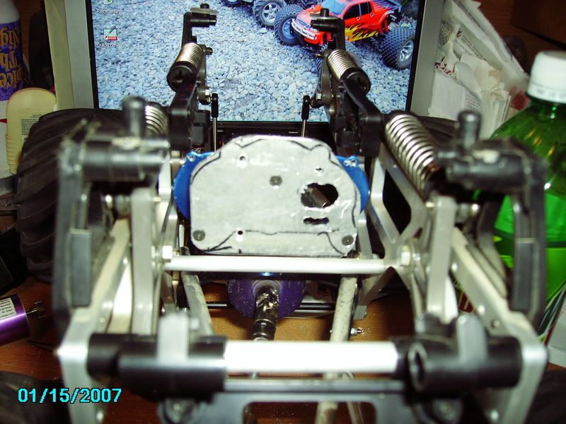

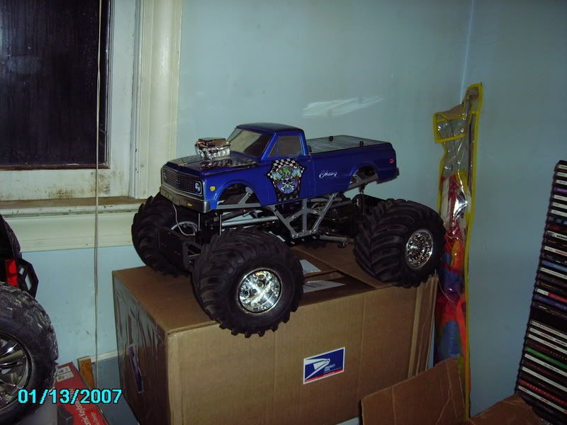

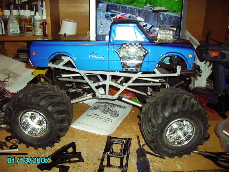

Well I went and got a txt. I thought I would share.
I have put a emaxx trans in and is debating on motor selection.
Peace!

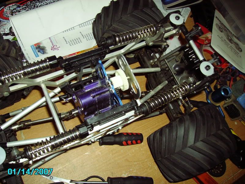

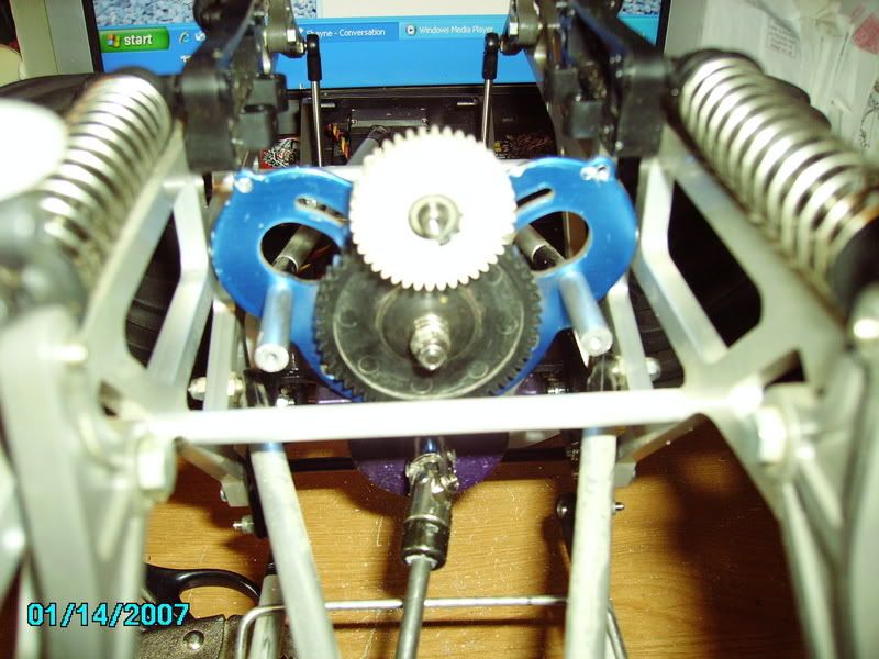

I figured up that my ratio was to high. I started and made me a new
reduction for it and changed where the motor mounted.

Cool txt! Why not use a GD600 for gear reduction? I have put mine through a 22t titan on 10 cells, 55t lathe on 12 cells, and a stock sliver can on 12 cells; it never failed me. (I think I put an HV-maxx on it once too...) I comes stock with a 5mm out put shaft that I milled down to 3mm with no adverse affects... (to accept 3mm pinions)

With the gd600 the motor would have been up against the battery tray.
The battery tray hold the servo for shifting as well. So I wanted to move it
to rear. The motor that is. I took it out for a test run. It was pretty neat.

Motor on truck is a feigao 12s.
I am running a 18.97 schulze esc.
I am running a 2s lipo as well.
Performane is ok. I need lockers.
I do have some body twist in it as well. will see about fixing that as well.
Overall am fairly happy with truck.
Like the way it looks more than anything.
